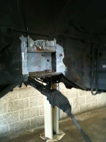

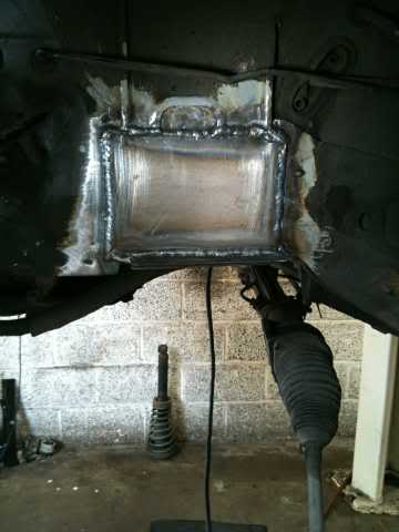

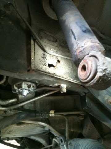

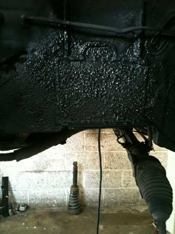

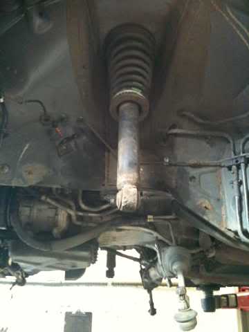

These are the photos taken by S&P Autos Newton Abbot, UK when they did the inner wing weld repair to my XKR:

Didn't look too bad, but I suppose a hole is a hole is a hole!

Couldn't have been in a worse place. They made a good job of cutting out the rot and patch welding.
Same both sides or just on the LH?

Both sides - I have to say I was very impressed with the job they did - but in total it was over £1000 to do the job - probably £950 to take everything off and £50 to do the welding! I did whinge, but in the end I think the price was very reasonable.

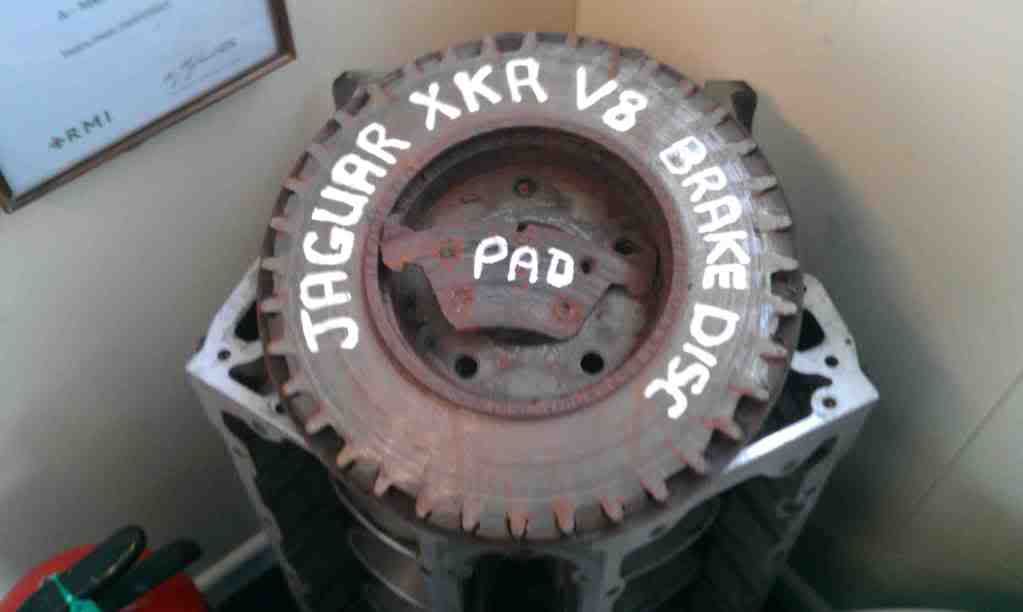

Just for interest the following is a front disc they took off a customer's XKR (Not Mine!!)

The owner certainly had their money's worth out of that disc and pad!

It's a major piece of work to strip the cross member out so not an unreasonable labour bill. Like you, I'm impressed with the job they did.
