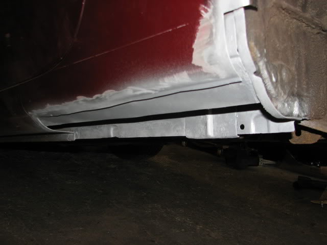

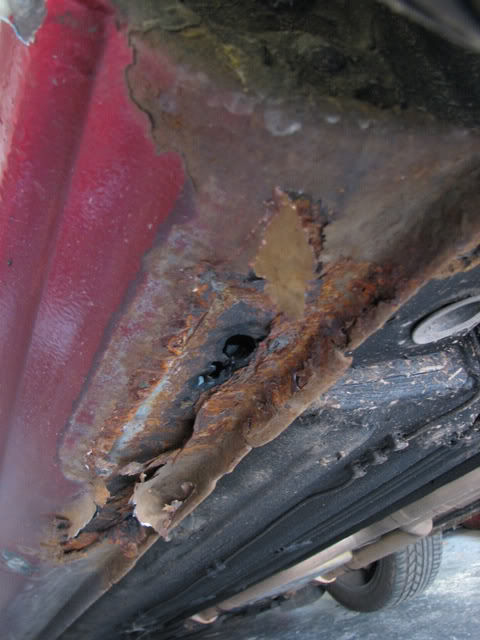

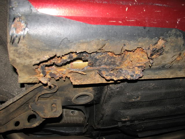

Nope same rust proofing all the way through I am afraid, if you want to see something really bad.... look at this

Every XK will suffer like this I am afraid unless pampered most severely

People living in the warmer climes I dont think will need to worry so much, those more to the north which is colder and the use of road salts will (like here in the UK)
No matter how much waxoyl/dinitrol you try to pump in, this will not stop this!!!
It is a design issue... The problem you have is the outer and inner middle sill, this is a double skin which goes from the join line you can see on the sill from about half way along you door. The sills are very close together and if you remove the grommets you can see and pump in as much as you can you are ONLY covering the middle sill and inner sill, NOT the middle to outer sill as there is no way the treatment can get in there.
The water gets in via the join around the inner wheel arch to the wing/fender, these parts are not welded together but are bonded, what happens is the bonding seperates from the wing and allows water to ingress between the sills plus other "stuff", in the above case which is worst case scenario, sand!
The biggest issue is you can not buy repair sections, you have to make everything yourself, when I remade the inner sill I drilled holes in it to allow waxoyl and the like to penetrate through, I also painted everything with weld through primer to help it along.
To prevent this from happening, check the seal of the wing to the inner arch, dig it out and renew it if you have to, where the bottom of the arch joins the sill fill it up with sealant so water can not sit in there. A good tell tale sign, if you have anything that looks like the pic below you maybe already too late!!
Even though this is the stone guard which is sprayed on to the sill and does not have much to do with the inner sill, in my experience if you have this your sills are on the way out, if the stone guard has started to bubble this is what you will find underneath it

There are things you can do but it will compromise the look slightly or you will have to fit side sill covers...
Drill holes into the outer sill and pump it full of wayoyl that has been well heater so it is very runny, of course you then need to cover the holes for future injecting, either with an unsightly grommet which you could color code to your XK or like I said fit the side sill covers..... Maybe there will be a market to fit a more standard looking cover just for people who want to keep a stock looking car....
The front half of the sill section is only single skin and will not have these issues, once you have removed the inner wheel arch liner you will see a grommet in the end plate you can remove and pump it full.....
It is a messy job

May I be so bold as to ask what these salvage jobs cost at Paragon on average?
£1000 to do both sides, like I said previously this was a worst case scenario, the car is a 96MY, has done over 120K miles and worked all its life, I must admit mechanically it is sound and was kicking 290bhp on the rolling road, which is pheonominal for an XK that has had such a life.
Originally Posted by ALAG
Hi XK Racer Thanks for those disturbing photos.Would it be feasible to drill and grommet under the scuff plate in the door opening or would that weaken the sill?Where does the single skin end? Is it possible to thread a a thin tube into the sill?
Lots of questions Thanks again Al
No in a simple answer, you can get right along from the front end of the sill cap, a grommet hides behind the wheel arch liner, there is another at the opposite end, take a look and you will see it. The inner and outer sills taper and merge at the join half way along, this means if you took both grommets out I guess if you looked down one end you would see light at the other?
If you also take a look at the inner sill I made, you can see towards the front it is together but at the back it sits inside the wheel arch, this is actually quite a thick piece of metal, when the outer sill is welded on you get probably about an 8mm (5/16) gap, which as said then tapers to nothing as it gets towards the middle, this is why it is difficult to get any form of rust prevention in there.
