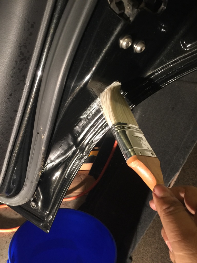

Cars will rust broadly for two main reasons:
-Poor design- which allows 'traps' to form that hold saltly water and mud for prolonged times and then encourage rust. In 'poor design' I also include poor protection- in terms of zinc coatings, insufficient under seal, galvanisation etc
-Poor quality metal- example of this are some of the 70s Italian cars, like Alfa Romeos and Lancias- which used poor quality Russian Steel.
Growing up in the UK, I would see Jaguars rust badly, especially older ones and I never knew if it was due to poor design or poor metal.
Having emigrated and gotten cars from great climates and just store them- I can answer the question of Poor metal: Jaguars use Good quality metal.
I found a 1971 XJ6 with only 16,000 miles - laying in a barn for years. CLeaned it up and got it operational- the car is superb underneath.
I never really drive it. Its cold where I live now, but the car never sees salt, and the extreme cold reduces the rate of reaction of rust.
My other car is a 2000 Model year XJR.
This is a Browns lane car like your XKs and uses the same sheet steel.
I'm very happy to say the car is also mint. I never use it in the salt or the winter. Its a Californian car, and was used a lot there, such that the laquer roasted off, but I've removed the sub frames and suspension and I'm astounded how amazingly mint it looks under neath. Because I'm paraboid and I've lost so many good beloved cars to tin worm, I still blasted it with special rust inhibitor compounds.
Here are some pictures after the compounds, but you can still see the quality of the metal. The car it self has around 100,000 miles on it.
