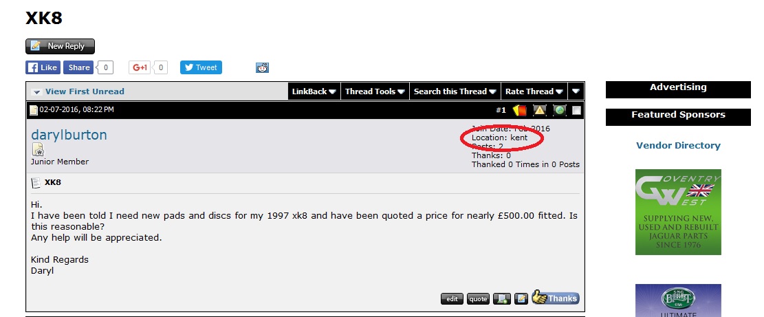

Old Feb 9, 2016 | 06:00 AM
Originally Posted by melhookv12
Where in the UK are you based ?
I'll take a wild guess at KENT as the OP hasn't been back!
Attachment 125264
Didn't help me in mobile mode graham. I did look before i posted my question. As if local to me i was going to offer some help.
