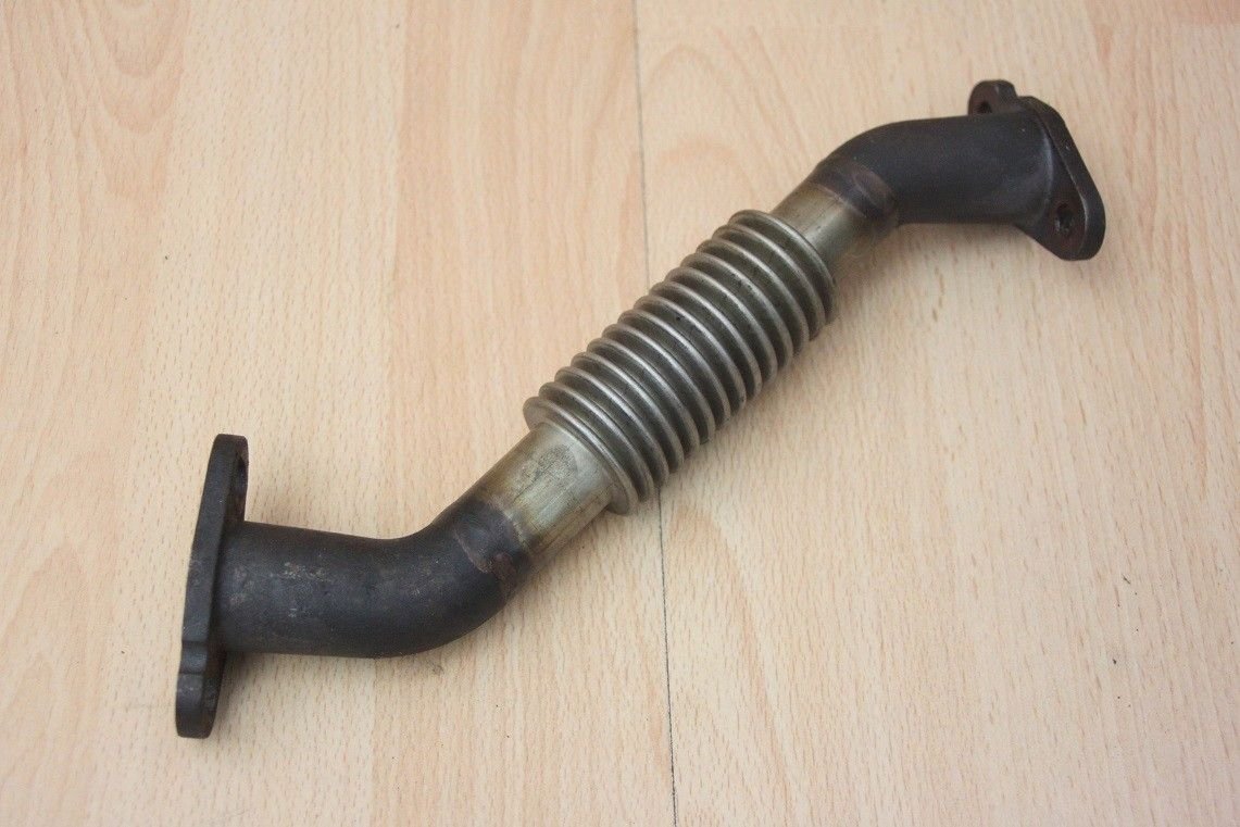

I'm looking for good exhaust gas recirculation pipe from a 4.2 salvage car. It's a pipe that runs from the egr to the cat on the right side rear of the engine. If you have one please let me know. See the attached picture.

Mine was split and giving off an odd sound that took a long time to track down, I was able to get it TIG'ed back together. Could that be an option for you?

That's a good suggestion. I'll see if I can find someone with a TIG welder. Thanks.

It is really thin metal so find someone that is confident to weld up a coke can. The guy I used bridged across the corrugations of the split area. Its been holding up for a few years now.
