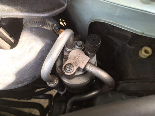

Can someone confirm which one of the ports to connect to, see photo's below.

Well the port behind the engine is the low pressure port.
I took the chance and bought the same setup as is in the video. $50 at Checker Auto.
Turned on the care and put a thermometer in the vent, set AC all the way down till Lo appeared on the display. Let run for a couple minutes and the temp stabilized at 60, connected the recharge bottle and charged up the system till just below the max charge noted on the guage. Temp on AC dropped to 50.

As you found which one it's a bit moot, but the port fittings are different sizes, the 'kit' will only connect to one (I believe from my other car(s) experiences).
