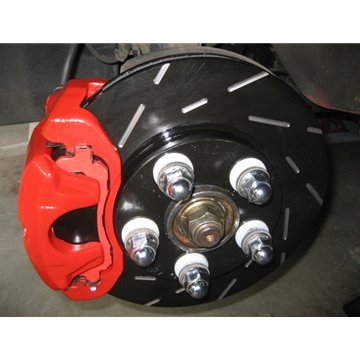

Here you go btw, also lower her tire pressure to 28 psi all the way around, that how the dealer did mine.It was in the instruction manual, and improved stopping and wet traction

Perhaps changing out the factory rubber flex brake hoses for aftermarket teflon/stainless flex hoses might reduce some of that 'spongy' brake feel.
I replaced my old solid rotors with new cross-drilled, slotted rotors, and sets of ceramic pads. Seems to have helped with better stopping and heat dissipation. Less brake dust build-up too!
