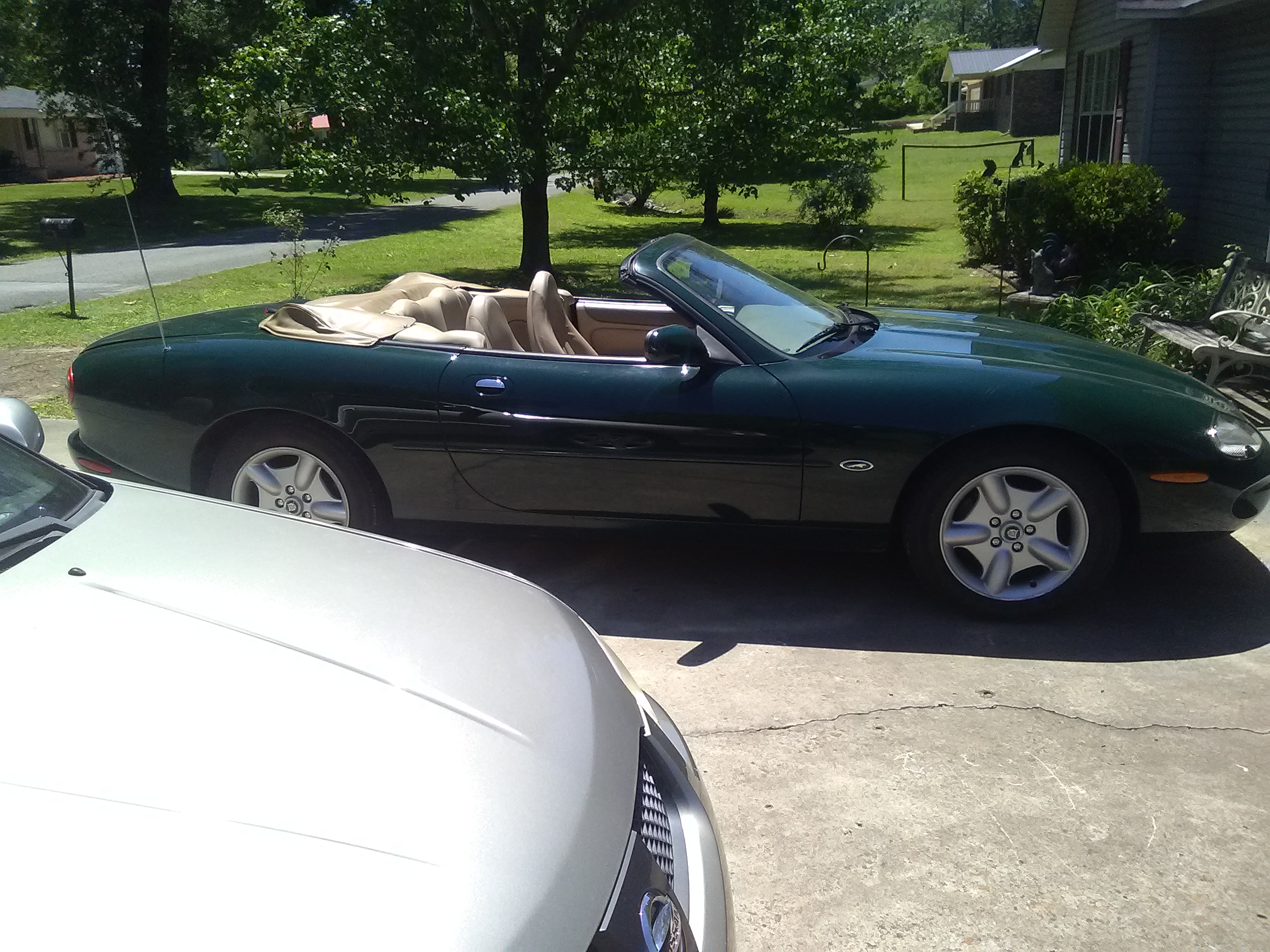

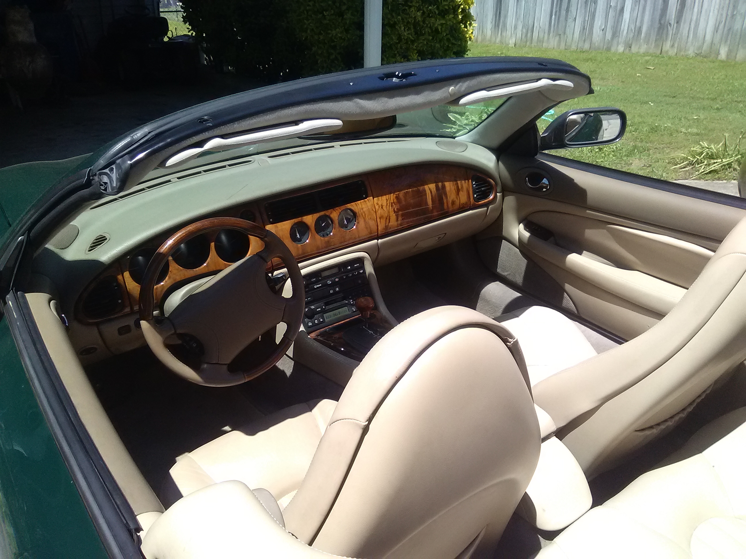

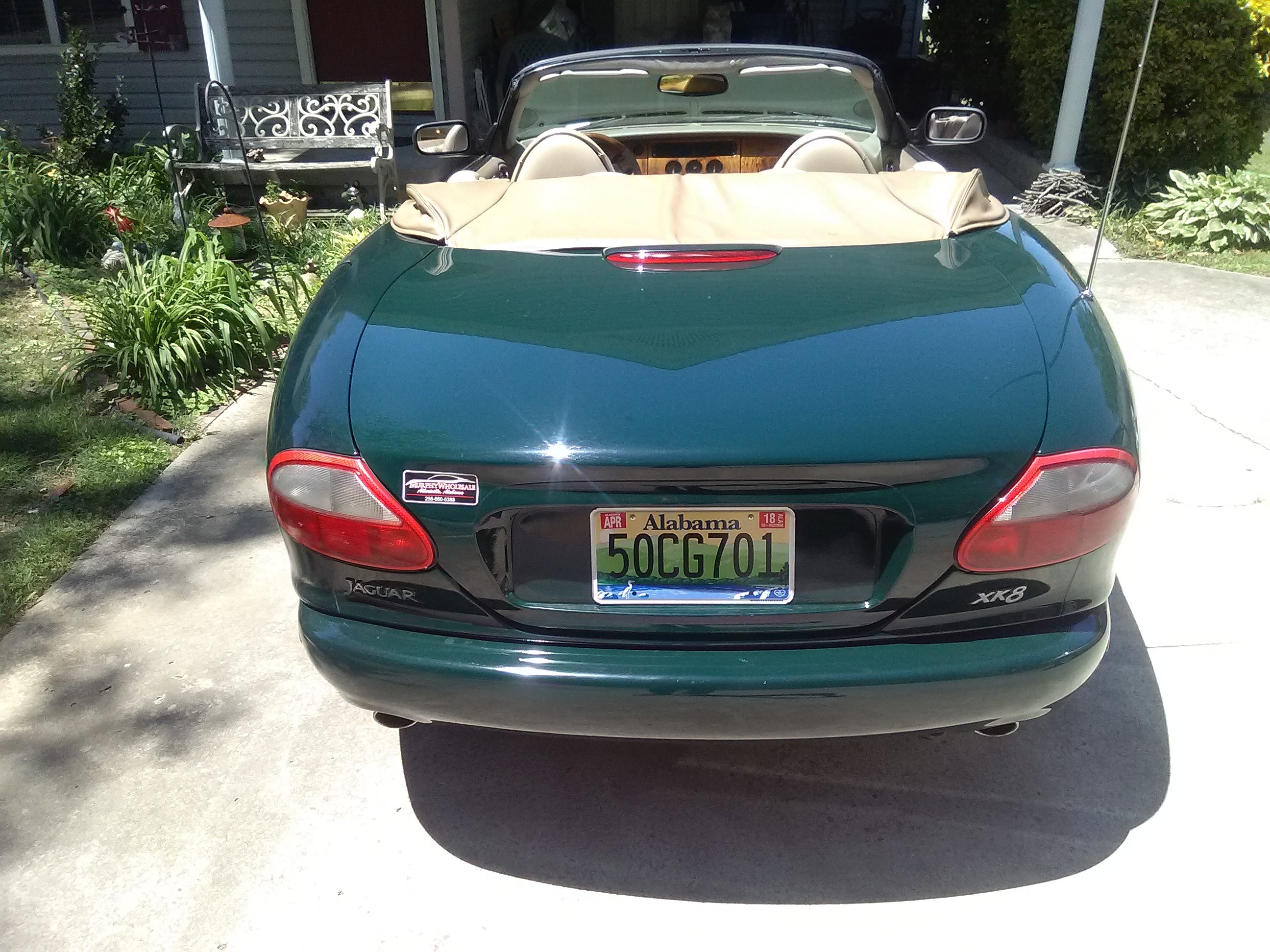

Here are some pictures of the Jag after I finished.
Attached Thumbnails XK8 Cracked Radiator End Cap-img_20170430_091933.jpg   XK8 Cracked Radiator End Cap-img_20170430_091917.jpg   XK8 Cracked Radiator End Cap-img_20170503_121134.jpg   XK8 Cracked Radiator End Cap-img_20170503_121204.jpg   XK8 Cracked Radiator End Cap-img_20170503_121215.jpg
XK8 Cracked Radiator End Cap-img_20170503_121222.jpg   XK8 Cracked Radiator End Cap-img_20170503_121232.jpg   XK8 Cracked Radiator End Cap-img_20170503_121246.jpg   XK8 Cracked Radiator End Cap-img_20170503_121308.jpg
