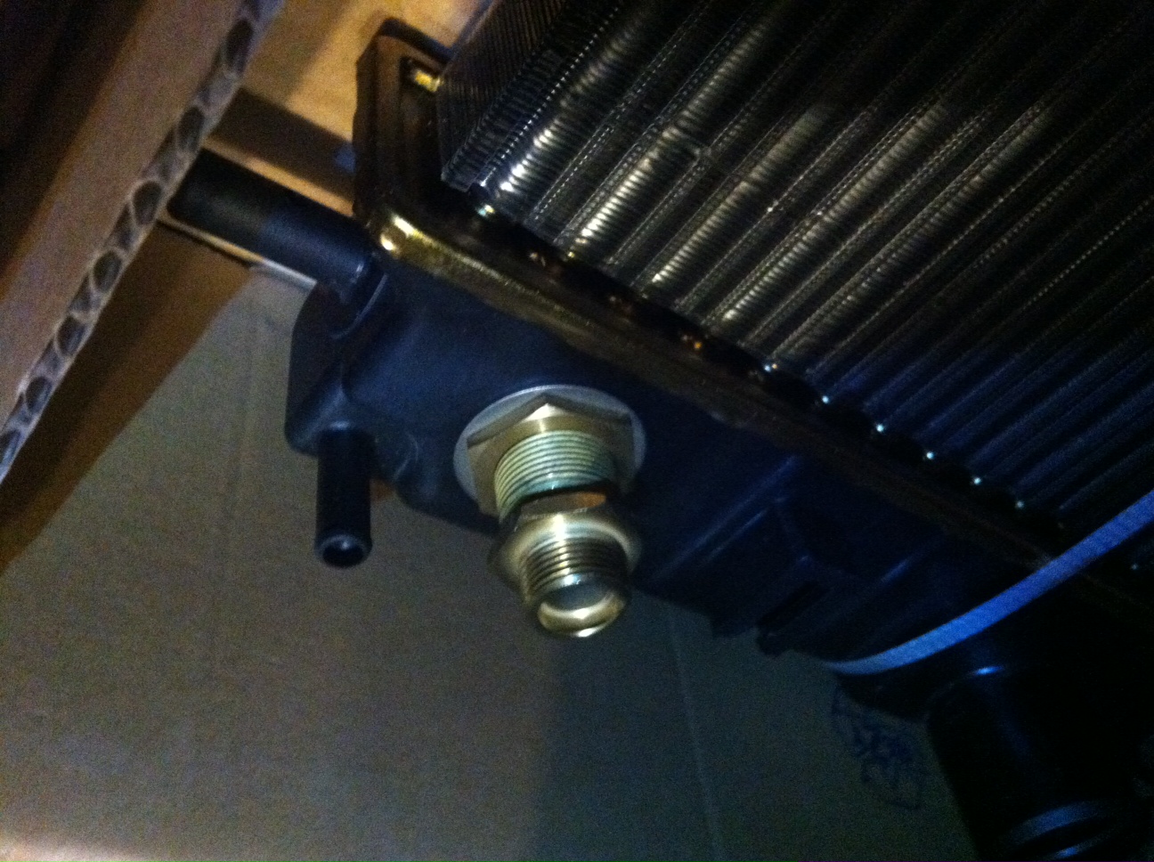

Here are pictures of the fittings. Wide mouth (female?) version is part# MJA4190AF and the one with the adaptor on the fitting (male?) is #MJB4190AF.
Everything I read says the XK8 takes the female fitting, but two different Jag dealers say to use the one I just got, which was listed as the male fitting. And the original one (wide mouth) does not fit my connections. A side note is that the adaptor will screw right into either radiator with no issue. AAARRGH!
Attached Thumbnails XK8 Radiator OEM Part#-mja4190af.jpeg   XK8 Radiator OEM Part#-mjb4190af.jpeg

I have now tried both radiator models listed for my 2001 XK8 from RockAuto and neither have the proper fitting for the transmission cooling lines. This is despite getting the correct part number from two different Jaguar dealers using my VIN#. All of these are manufactured by Nissens, which I believe was the OE supplier.
Either I have a unique radiator, the Nissens models have changed or the Jag gods just hate me. I must admit I am beginning to believe the latter.
So, I can order the part from a dealer at a much higher price in the hope they know which will fit (never a certainty) or take it in for replacement. I might look at trying to buy an adaptor from some plumbing supply with the correct ends as this is how the 2nd radiator came. It just had the wrong size on one end of the fitting.
Net result so far is that I have nearly $1,000 worth of parts I cannot use and a leaky radiator. No joy here.

OK, I installed the new radiator and all hoses this last weekend. Turns out the MJB4190AF that works on both the S/C and N/A models does fit my XK8.
I bought a Nissens radiator from RockAuto. A few differences of note for this install, keeping in mind it was my experience, YMMV.
There is a plastic piece (relief bleed tube?) on the upper left hand side of the radiator tank that is blocked on the XK8 N/A version. It is open for the XKR S/C. Coolant will really run out of there fast if you don't know that. Luckily I tested it in advance for you. A short piece of fuel line and an end plug...good to go.
Also the new radiator did not come with the upper and lower channels that the foam OEM radiator seals go into. The RA version left it off and fits further away from the body work. I was able to fit a seal on the top by wedging it in under the top plastic mounting panel. It did not appear to be needed on the bottom.
Otherwise, everything was a good fit and the car runs at normal temperature with no leaks so far. To avoid ordering the wrong part like I did, I strongly recommend using your VIN# to get the correct part number from the dealer.

Graham,
I suspect you are correct. This was the case on my original radiator and expansion tank. However, on the replacement radiator it was not blocked. hence the need for my engineering fix. Just FYI, the first radiator I ordered was the wrong model and it too was unblocked.
The attached photo shows the hose fitting under discussion.
p.s. can't seem to get the picture turned upright, sorry
