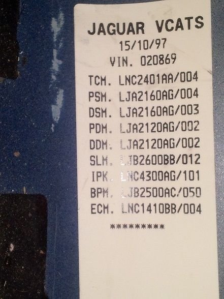

Hi,
I don't specifically, but if they're both LJA1410CA then they're interchangeable. The only difference I would expect would be the internal firmware revision. This isn't printed on the ECU itself, but it will show on your VCATS label in the spare wheel well (the /nnn suffix):
from my '98
I would strongly advise opening up any replacement ECM and changing all the caps in there unless that has clearly already been done recently, or the new one comes with a warranty.
