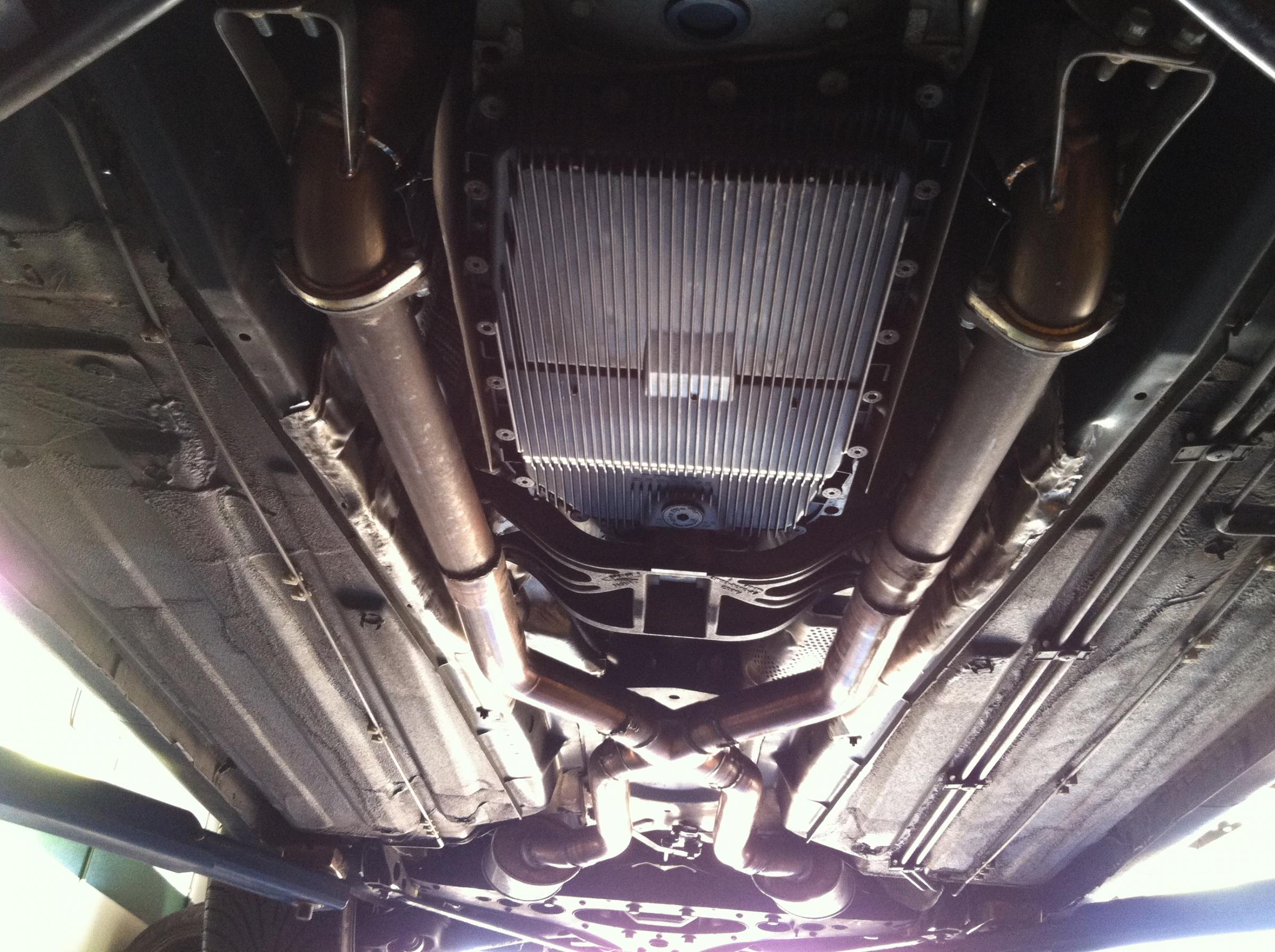

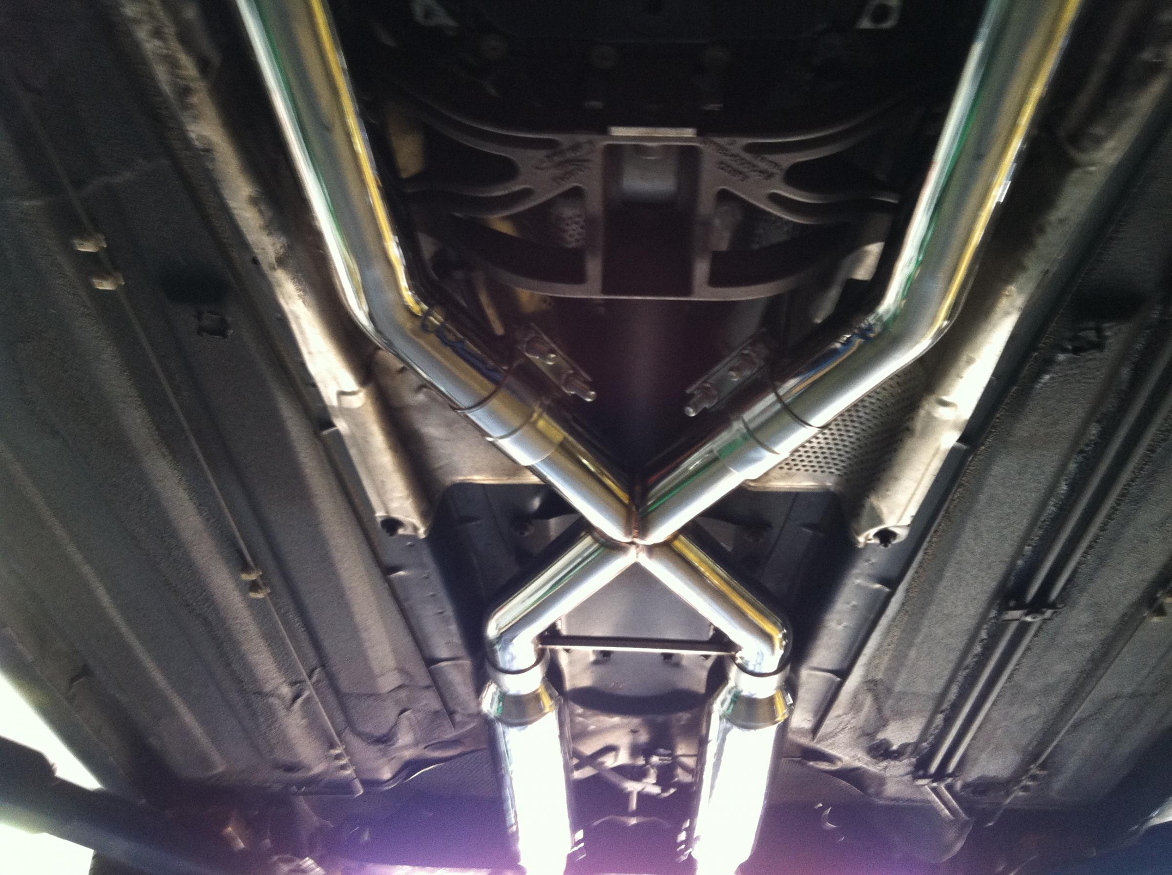

Here are the shots of before and after with the MacLeod system. I started off doing this piece by piece and it just got ugly. Should have done MacLeod from the start or just stopped at the rear muffler delete and gone to the Nameless cats. Good lesson in not doing something by hit and miss. This got really expensive though the short run with the cutouts was kind of fun.
Attached Thumbnails XK8 exhaust without center muffler-img_1041.jpg   XK8 exhaust without center muffler-img_1043.jpg   XK8 exhaust without center muffler-img_1044.jpg   XK8 exhaust without center muffler-img_1045.jpg   XK8 exhaust without center muffler-img_1046.jpg
XK8 exhaust without center muffler-img_1048.jpg   XK8 exhaust without center muffler-img_1049.jpg   XK8 exhaust without center muffler-img_1050.jpg   XK8 exhaust without center muffler-img_1051.jpg   XK8 exhaust without center muffler-img_1052.jpg
XK8 exhaust without center muffler-img_1053.jpg   XK8 exhaust without center muffler-img_1054.jpg
