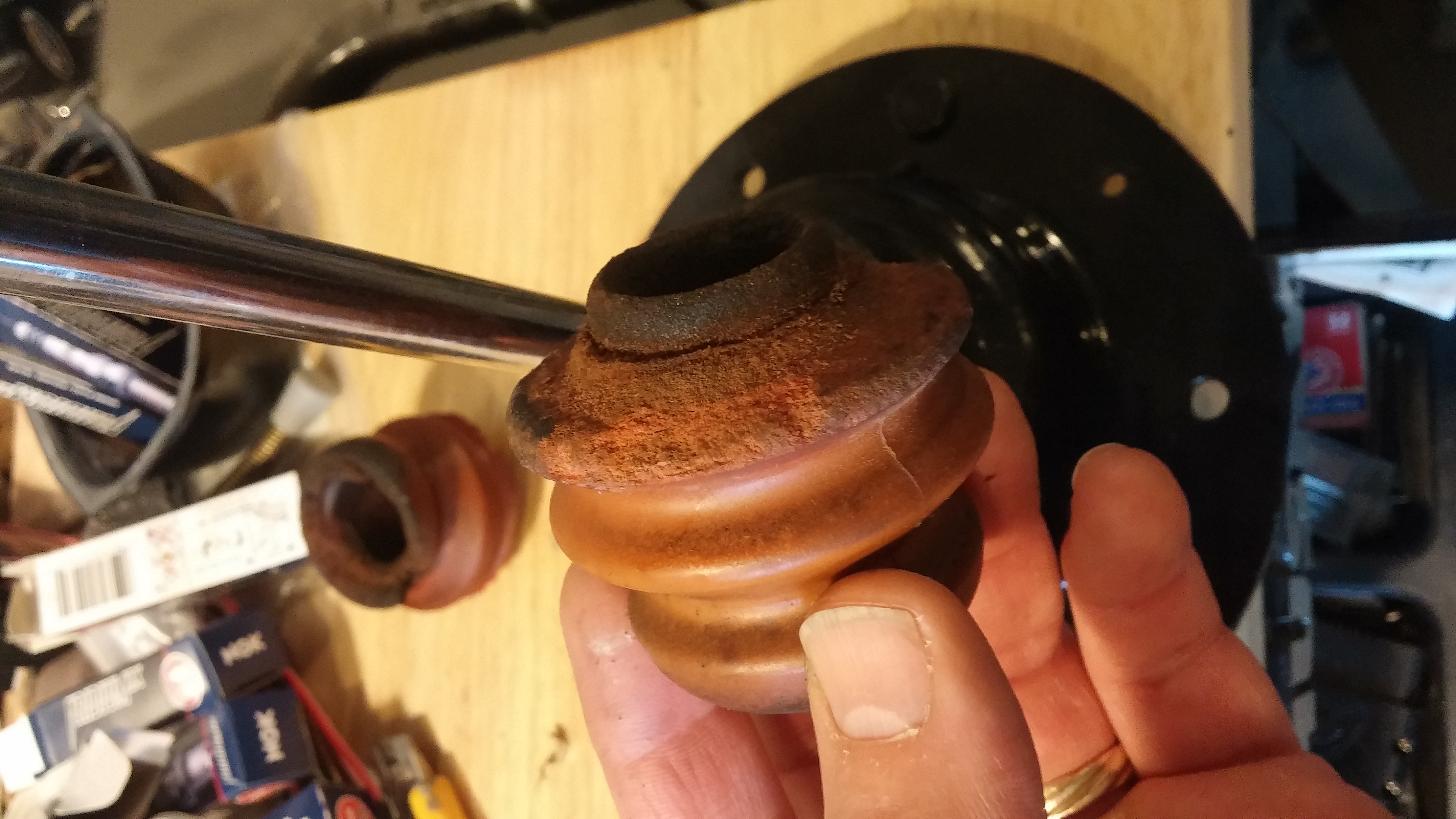

XK8 front coil springs - What was your experience?-20170313_140715-1-.jpgMy springs were also slightly sprung. I chose to maching a shim on the top of the tower (flat doughnut disk with 2 inch hole in middle for CATS wire and three holes for strut mount. 1/4 thick got me to nearly stock height.
What is important though is that upon removal I noted the bump stops were severely damaged. See photo. The bump stop has an oversized center hole and is friction fit to hang from top of strut tower. Eventually it falls out and gets cockeyed as each bounce erodes the edges. My bump stops had eroded down to 1/2 the original height.
This allows the spring to overcompress beyond what was engineered.
Solution. New bump stop is set into boot with silicone then boot into top mount with silcone as well. Then, take a short piece (inch) of heater hose, cut a slit and snap it around the shock tube. Slide it into the bump stop. The friction of the rubber hose will help to keep from falling and the diameter of hose will keep the bumpstop centered. (in photo I udsed my old stops for demonstration) 5000 miles later, working perfect and never bottom out or hit a parking stop.
If you try the shim method to regain height, be carefull of some aftermaket strut top mounts use shorter bolts. For anyone concerned about the safety of the shim, Just my opinion, but because we have upper control arms (A-arms) the primary forces on the tower are verticle loads.
Good luck.
