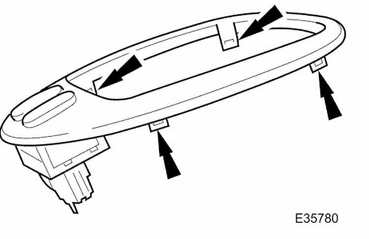

the CC use is different, and it does make sense if the bezel latches to the inside (toward the gear shift lever). I never looked that hard I suppose. Detail pic of the bezel tab handy so we can see which way?

Paul Pavlik's Avatar
Join Date: Aug 2009
Location: Milwaukee, WI
Posts: 1,205
Received 430 Likes on 323 Posts
This pic shows the Bezel. Unfortunately, the tabs are not shown clearly. The Tabs actually point INWARD.
Note: The pic shows what could be seen as SLOTS at the bottom of the tab structures. They aren't slots. They're actually the "Tabs" that extend inward

Well, that little 'tip' should save some tabs from being broken in the future. Nice addition guys.
