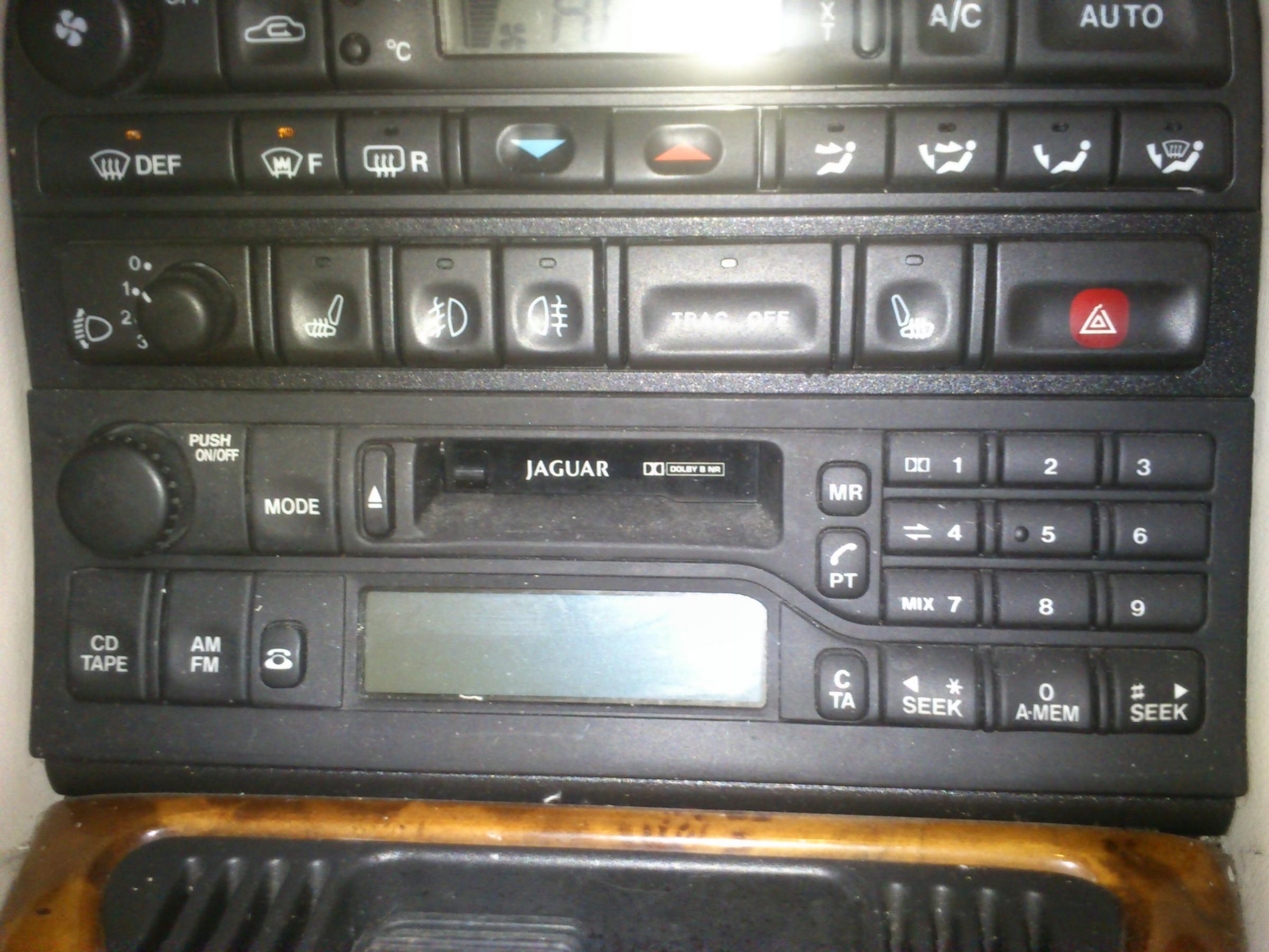

Pic of the radio attached (I hope). It does worry me a little that a NA unit might not work in the UK too. Anybody ever imported/exported an XK?
Very dim memory on this, but here goes ... when I got my '01, about 8 years ago, the radio was in some sort of "Europe" or "UK" configuration. I had to research how to give the radio special instructions so it would learn to speak American. Sorry, I just can't remember more, but this would seem to indicate that our radios can adapt to either side of the pond.
Colonies v. UK: Are the channel spacings different maybe? Here we use 200 KHz spacing for FM ... e.g. 93.1, 93.3, 93.5 MHz
(It's possible I dreamed all of this.)
No, you didn't dream it. Like you, something rang a bell & I've done a little digging. Most of the following is courtesy of Davebc in this thread:
https://www.jaguarforums.com/forum/x...untry+settings
Note that the discussion is about a 2003 vehicle, so YMMV. Key seems to be that if the 'country' setting is changed to EURO, then the radio will start demanding a 4 digit code if it's left unpowered for more than a short period of time. So don't change that until/unless you have the code (dealer).
There's also the question of Premium vs. Standard, but that appears to be a simple switch with two options, "STD" & PRM"
...Oh, and you're not going to hear any American stations on it
Seriously, I'm sure I've read that at least one member here has taken a US vehicle to (France?). If it's the same head unit irrespective of its final destination, then it should be possible to configure it to work wherever.
