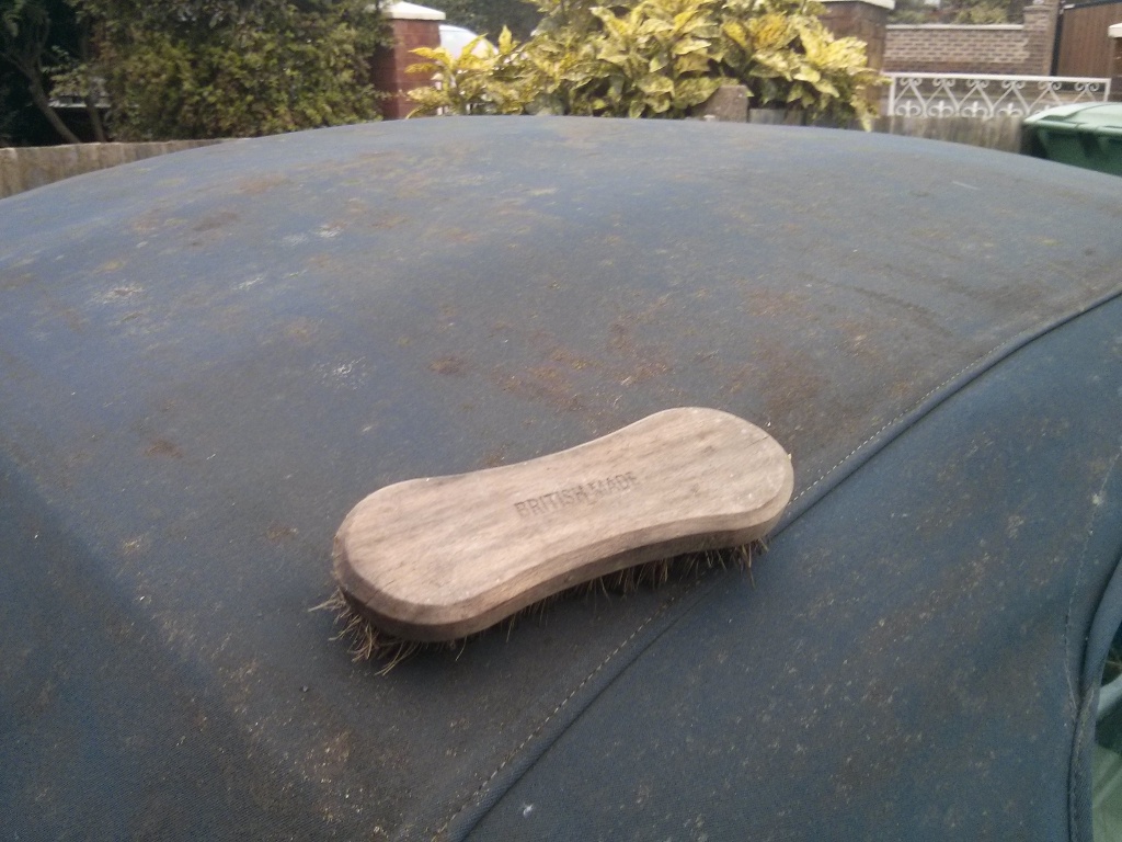

Today I thought I'd see if the Boracol on the roof had killed off the green growth. Well, it looks like some of it had definitely died off. A scrub with some top-tech brushes (see pic) with warm water and 'flash' loosened up some more of the growth and turned it into a sort of mud. Washing with a hose didn't get it off very well, so I tried the upholstery nozzle on the wet and dry cleaner with hot water and 'flash' cleaner in the water. Amazing result... see the pics...

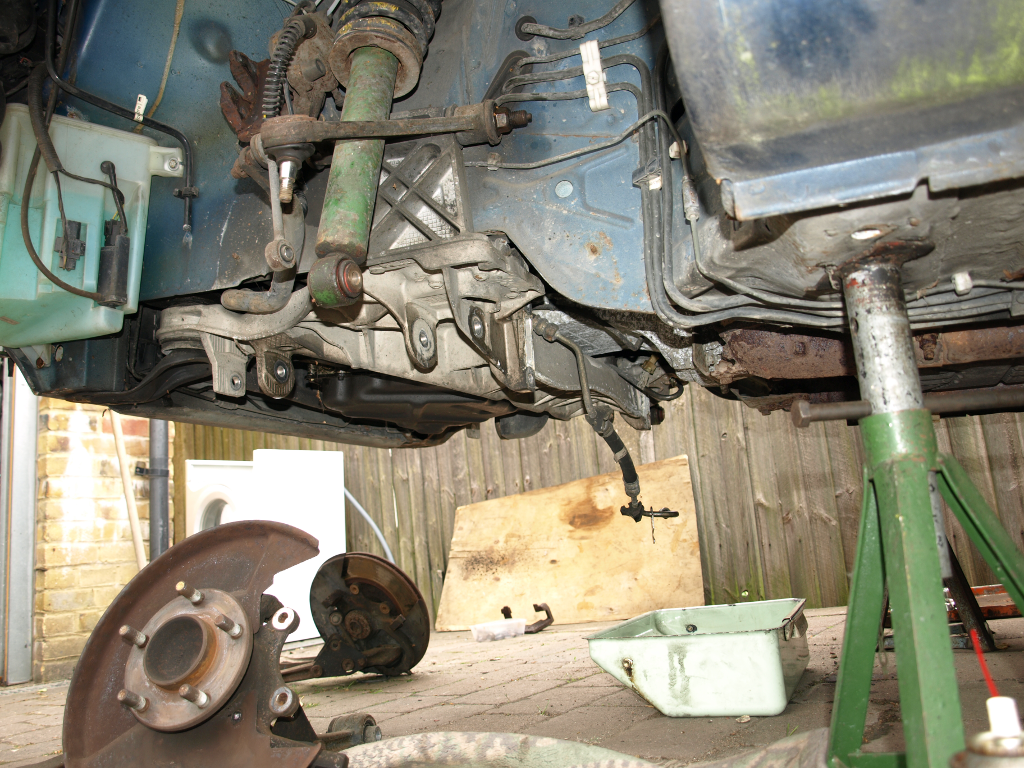

Then a few weeks later, I've managed to get a day on the car, so removed the subframe as follows:
Removed all the nuts and bolts from the suspension uprights, and removed them along with the lower arms. I think it's easier to undo when still attached to the car, and it makes the subframe lighter to handle. And what's with the weird track-rod ends? The ball has an off-centre mounting, so that turning the ball in the joint will adjust the tracking. I'll have to load the manual to see how to put it back together.
We took the front bumper off so that we could get at the X cross frame bolts. Seems to make it easier to get round the front of the car, and also makes it easier to clean everything nicely.
Then removed the cross-frame bolts, only one sheared off, the rest, surprisingly came out. One was so rusty that there was no thread left. That one came out really easily.
Then started on the steering rack. Out with the steering column UJ bolt, which is only 10mm, and as it's steel in aluminium I was sure it was going to shear off. It didn't. The bolt was stronger than I thought. Marked it with white paint so that it will go back on in the same place. Then undid the hydraulic hoses from the rack and let them drain. Have heard horror stories of rack mounting bolts shearing, but they all came out quite easily too. One of the hydraulic pipes gets hooked as you try and lower the rack, but keeping the rack high and a bit of twisting gets it out. Do remember the electrical connection. Oops.
Then used a piece of fence-post, and a strap to manufacture an engine support across the inner wings. Not very Jaguar, but it seems to work.
I was expecting even more grief the subframe bolts, but with care, they also all came out. The V-mounts between the subframe and the body literally fell apart. The fnece post did a good job of holding the engine, and the subframe came out on a trolley jack.
The power steering pipe was a surprise. The car has 54000 miles on it, and the pipe to the power steering has nearly rubbed through against the subframe and the air-con pipe.

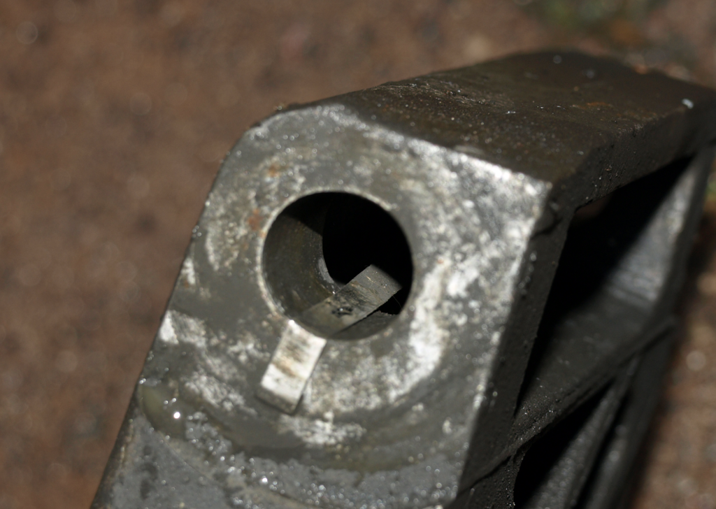

Time to investigate the issue with the rattling top wishbone. Both top wishbone bolts came undone easily and were fairly easily knocked out. Nothing was seized. Then it became obvious why the left side had worked loose and enlarged the hole in the subframe. Clearly the hole in the subframe was too large from new. There was a piece of shim material pushed in the hole to take up play. I know this car's history, no one else has been in there, this was a factory 'custom' fitting job! I'm not fancying my chances on a warranty claim though.
There's rust behind the subframe in both chassis rails, so time to chop some metal out and call in the welder for both these and the floors.
I think I was quite lucky. Only one sheared bolt, and wishbone bolts that came out as they should.

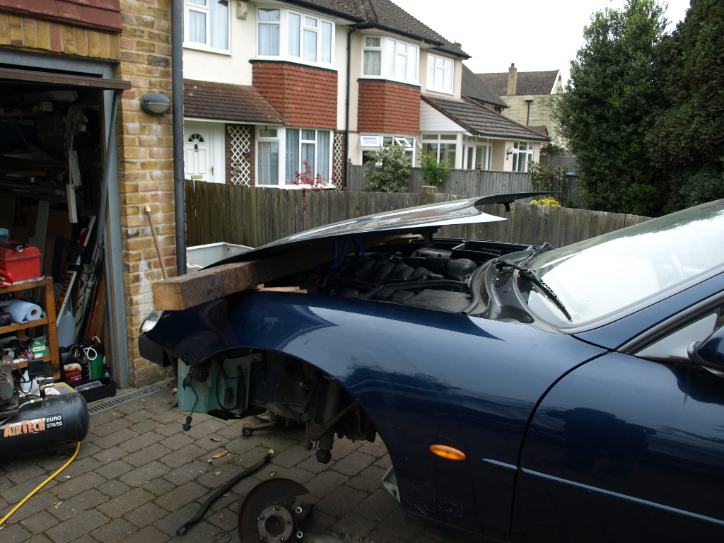

Following the subframe removal, we really needed to get the bonnet closed to stop the rain getting in. The fence post used as an engine support needed to be removed. We looked at the engine and decided to support it from underneath, with a pair of legs against the engine mounts. Now it may, or may not, be a fitting end for a 100 year old oak refectory table, but the oak legs shortened and braced provided a strong enough support. Oak is a fabulous hardwood. Removing the support from above the engine takes the weight off the inner wings, and I hope means the front end won't drop or move when I cut out the rusty bits.
Oak engine support frame. AT least the bonnet closes now.

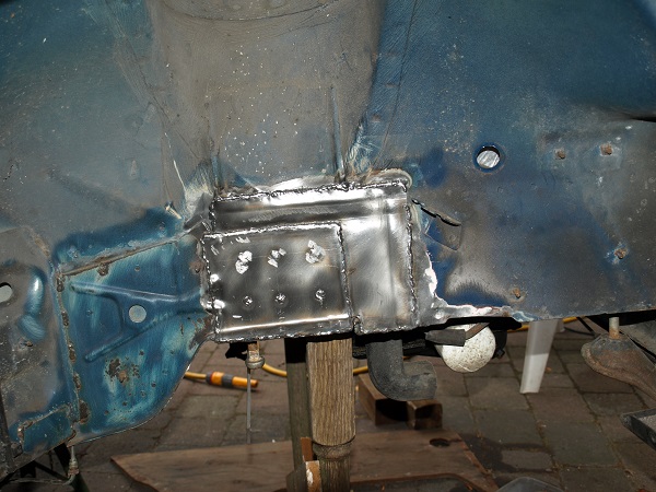

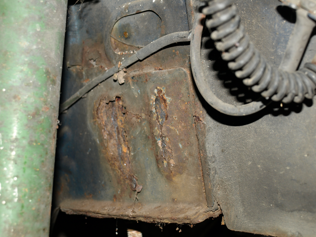

The rust in the front subframe mount area looked bad from the outside, but I wasn't expecting what I found after attacking it with an angle grinder.
Before cutting:
Left side before cutting. Slight rust?
Drilled out spot welds, ground out edges.
Final cut out on right side. Still more to cut on the base.
Jag chassis rails -reassembly is the reverse of the dismantling procedure the manual says...
One of the floors, after being attacked with the jigsaw...
Drivers floor after jigsaw attack.

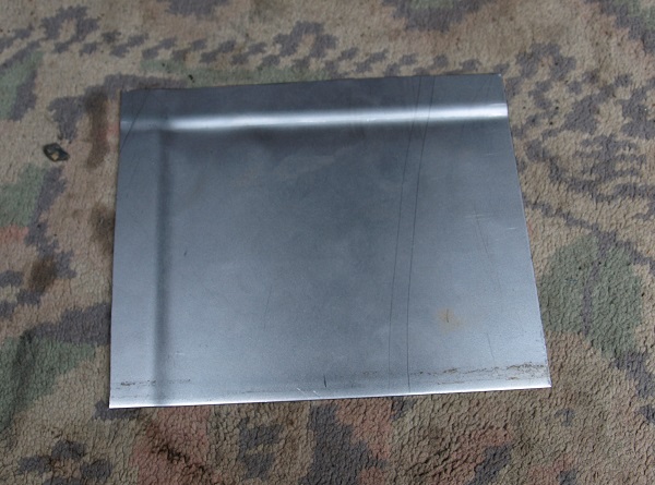

New panel made up to fit. A bit of folding and flattening and it seems to fit ok...
So that's all the rust cut-out and panels made for the floors. I call that progress. This week I hope to exchange a few more doughnuts for some 1.5mm steel to make up the inner arch panels.
Then a quick call to the mobile welder guy, bolt in the new subframe and get an MOT. Should be ready in about a week then???????

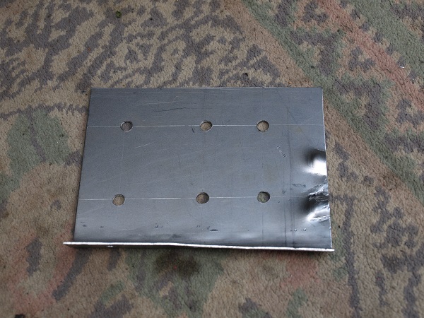

I've finally managed to spend a whole day on the Jag, wielding a mig welder that a friend lent me, as he has no garage space for it. Useful.
Not having used a Mig before, I spent a couple of hours reading and experimenting with offcuts of steel, having previously swapped donuts for thicker 1.5mm steel offcuts again. Starting with something that looked like bird pooh dropped from a height, I did end up with a nice smooth lap joint on both the 0.9mm steel and the 1.5mm. What makes thing not quite so easy is that the MOT test here demands that the welds are visible from the outside, and are continuous. Access is not easy when the car is on axle stands in the driveway.
At some time you have to stop drinking coffee, staring at the hole in the floor and contemplating the task. You have to put on all the safety kit, have a garden hose handy just in case, and hit the car with the arc. (Having disconnected the battery first!). You can see the results in the pictures.
I used 0.9mm for the floor and two layers of 1.5mm for the chassis to try and replicate the original strength and construction. I was surprised how well the 'holes' version of spot welds worked.
Before welding the chassis, I put the vaccum cleaner into the rails. Of surprise was the number of large stones in the rails. Not a standard fitting I hope. Also, what's with the layer of flattening resin filler on the inner wing? Were they expecting Jaguar drivers to look under there and complain it wasn't flat enough?
Anyway, all the welding is now complete. Both floors and both chassis rails.

The top wishbone bushes seemed easiest to fit if taken apart first. Then they can easily be pushed in by hand. It helps having your glamorous assistant (in this case my friendly ex-aircraft engineer, Jack) hold the wishbone for you.
Top wishbone bush taken apart.

Refitted brake pipes. The plastic clips are very brittle, and they all broke. Ordered 16 more.
So.. moving on... fitted new V mounts to the subframe, new anti-roll (sway) bar bushes, and offered it up to the car after supporting the engine on the very technical fencepost support. Subframe went straight in.
Engine held by subframe instead of the wooden table legs. Progress.
