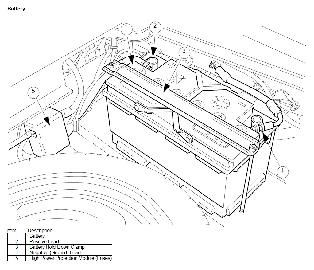

Battery has to be the first suspect - especially when you see odd messages appearing in the dash display.
Next favourite is connections in the High Power Protection Module (see item 5):
Cable connections are known to come loose or break at the lugs.
