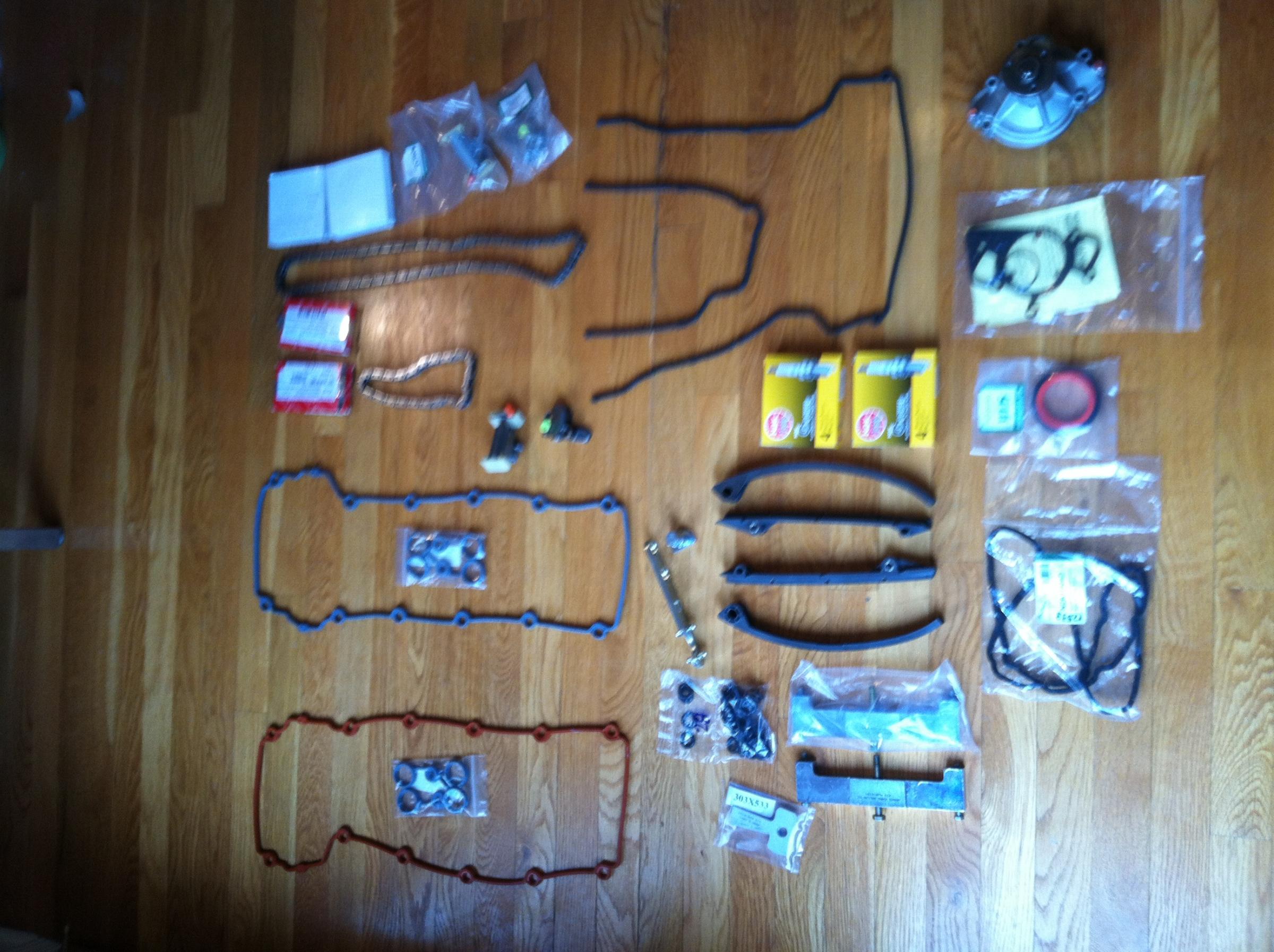

I have a 1998 Jag XK8 with 109K miles.
The timing chains and tensioners have never been replaced.
I bought all the parts to do the job myself and I'm starting it this week.
I will keep you posted with lots of pictures.

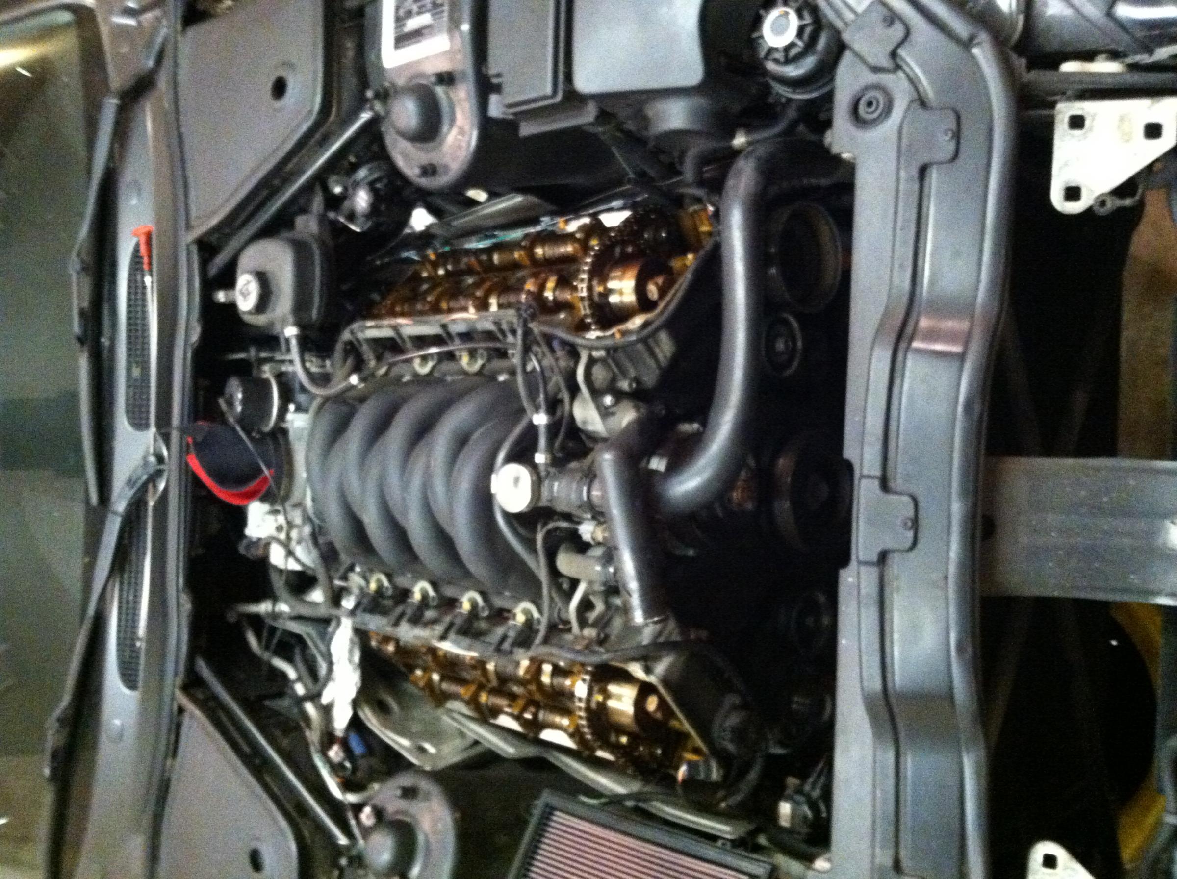

Not too bad so far. First thing I did was to remove the hood. It's not a very heavy hood. Then disconnected the battery.
When I got the cam covers off I did see that the tensioners plastic housing on the passenger side was broken off and pieces were lodged down in the cam. Easily removed.
I drained the oil and removed the fan housing and belt. Plan on removing the oil pan and checking the oil pump. Pretty easy stuff so far. The hardest part was getting my jack stands under the car. The frontend sits real low and my jack doesn't getting under it from the front. I need to do some work on the frontend but I don't know what is causing it.

Looking at the photograph of parts on the floor it looks as though the primary guides and slippers are not the latest type - i.e. alloy with plastic overlays - or am I seeing it incorrectly? Could just be the camera angle?

I found out that one of the cams on the passenger side jumped timing.
This is the side that had big pieces of plastic broken off from the tensioner.
I install the cam lock down tool and moved the crank to line up the flat spots on the cams. Drivers side is good and lined up fine. The other side is not. looks to be off by maybe one sprocket tooth. The chain is loose on this side and the tensioner is broken. Think I have found my problem.
One cam is slightly off timing. Does anyone know if this is enough to cause a bent valve?
The car before I started the project was parked for 6 months or so after I realized something was wrong when I had it out for a drive. It starts up fine and ran's but at 1500 to 2000 RPM's the rough sounds from the engine started coming out.
The large pieces of plastic from the tensioner housing was lodged into the cam that is off timing. More later!
Got the plugs out as well. They have white tips on the plugs. What does that mean?

Do a compression test to check the valves.(Once the top end is done) The cams won't line up if the chain is slack, so don't worry. The hold down tools and tensioning tool will make sure you're good to go when you're done. After you remove the hold down tools, the cams will turn a little because of valve spring tension. That's normal.
White plugs could be normal to lean fuel mixture. You can deal with that later.

If it is off only one tooth previous info on the forum says it will run rough but no valve contact or bent valve. Two tooth jump....pull the head and fix valves.
