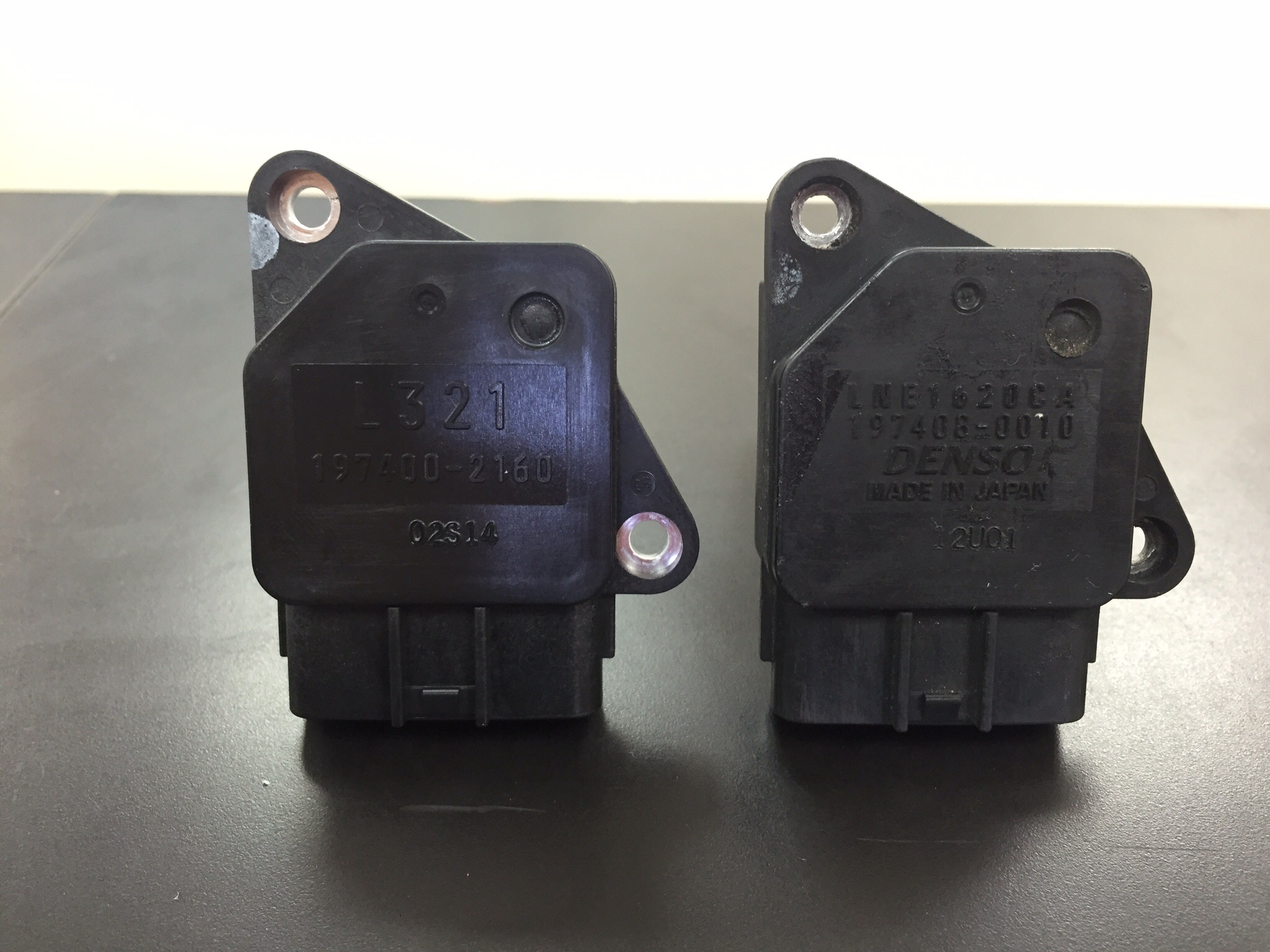

Yes, for those looking to buy a new MAFS, the Mazda part from the 06' Mazda 3 is identical.
This is the part number 197400-2160.
The sensor also has this engraved on the plastic: L321.
