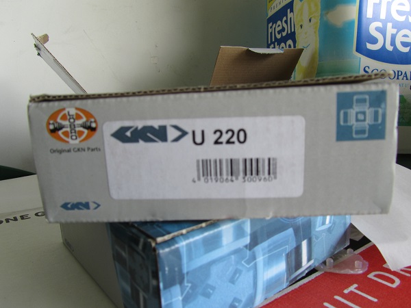

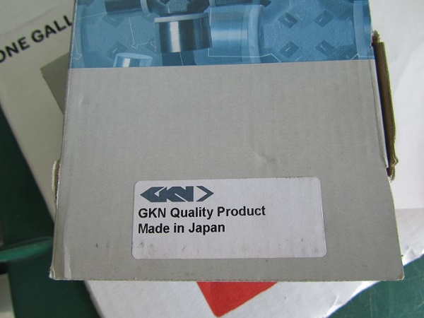

Default U Joints - these from GNK are genuine
I got some GNK U22 Universal Joints and was suspicious as to if they are really GNK's. They say GMB and made in Japan. I took Photos and contacted GNK. Emailed the pics. THEY ARE REAL.
Regina
Customer Service, Rockford | GKN Land Systemser
Called me and emailed me back. She stated that they are engineered/outsourced from the GNK division in Germany. These meet GNK specs and are real.
Attached Thumbnails XK8/XKR - OEM cross-compatible & Non-OEM interchangable Parts Thread-img_gkn-label2.jpg   XK8/XKR - OEM cross-compatible & Non-OEM interchangable Parts Thread-img_gnk-upc4.jpg   XK8/XKR - OEM cross-compatible & Non-OEM interchangable Parts Thread-img_gnkasgmb.jpg   XK8/XKR - OEM cross-compatible & Non-OEM interchangable Parts Thread-img_endcap6.jpg   XK8/XKR - OEM cross-compatible & Non-OEM interchangable Parts Thread-img_gmb8.jpg
