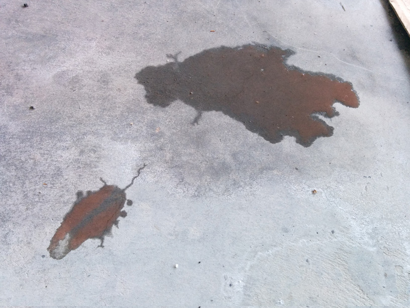

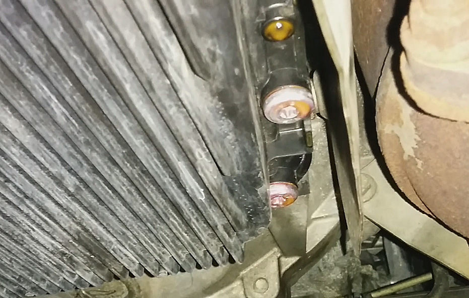

I've been having a small coolant leak for the past month. Haven't been driving much at all though, but it appears it is getting worse. The coolant drips down from the transmission oil pan. There are traces of "orange splash" on the passenger side of the transmission.
I have investigated the engine compartment as much as I can, with intake off, so I can have a clear view under and around the throttle body, but everything looks clean. The space on the passenger side of the transmission is so narrow, it is really hard to find anything at all, especially without a lift.

1. Drips of coolant at that location can often be from a pinhole or small crack in the Expansion Tank. Difficult to trace!
2. without hooking it up, I can't recall if SDD reports coolant level.
3. the coolant specification for your MY is WSS M97B44-D coloured orange, Extended Life Coolant. A 50/50 mix with water (I always use distilled). Change frequency is 5 years.

1. The expansion tank is on the drivers side of the car, but I see the traces on the passenger side of the car (LHD here). Still think that could be it?

1. NO - not the Expansion Tank. My brain was in RHD mode!
3. I use Jaguar coolant. With a change interval of 5 years any additional cost is insignificant compared with the fuel I use in that time.

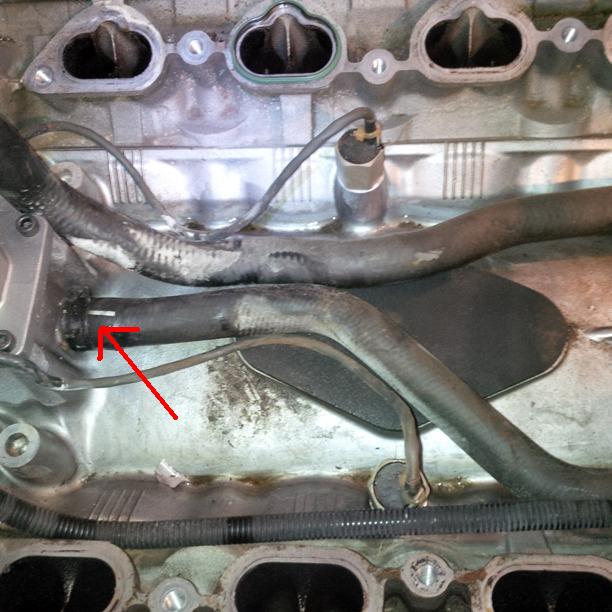

Azeteg, that's exactly where mine was leaking. It turned out to be both the tunnel hoses and a crack at the back of the thermostat housing. The coolant ran down the valley and dripped off the transmission housing. I used a pressure tester, flashlight, and a dental mirror to locate the pin hole leaks. I was able to change them out myself, (half blind, ham fisted, arthritic, semi geezer) and the job is complicated by your super charger. If you find that is the issue there is a lot of documentation on this forum to guide you through the process.

Great answer Fulton- key here is pressure tester. It allows you to "force" the leak to happen real time as you are looking around for the drips.
I wish someone would have told me to buy one years ago, it would have saved me untold hours and $ on parts just guessing.

I managed to locate the leak today. Leak is very small, and doesn't always happen. It is the Norma connector where the heater hose connects to the engine metal pipe, and I've seen threads where this is being discussed as a common place for coolant leaks.
I guess I need to get myself a new heater hose then. While I'm there, any other items worth replacing? So far I only think of doing a proper cleaning of the throttle body, inlet elbow and EGR Valve (replacing gaskets when putting it back together).
