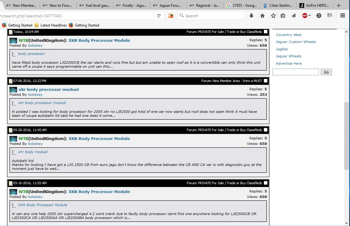

You've posted this same question in at least three different forums here:
I've moved this latest one from General Tech Help to XK8/XKR forum. Members here with the same model will be able to help.
In previous posts you wrote you'd obtained a BPM (Body Processor Module) from Eurojag and the car was with your 'diagnostics man'. You also didn't understand the different part numbers.
