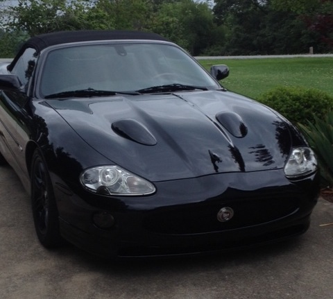

Originally Posted by XKRacer
They do sit a bit proud if you do it the way Frog has suggested and you will have to remove a cross section of the inner bonnet/hood panel.
I make carbon XKR bonnet skins which you can fit to an XK8 inner, not cheap, but again I can also make them out of GRP, you best/cheapest bet would be to find a breaker
Ooo, ooo, ooo, need. To. See!!!!!
Not loving the lady lumps I got with my arden style kit from mina!! Although, I've had tons of good comments about them from admirers. Who knew?!?!?!
