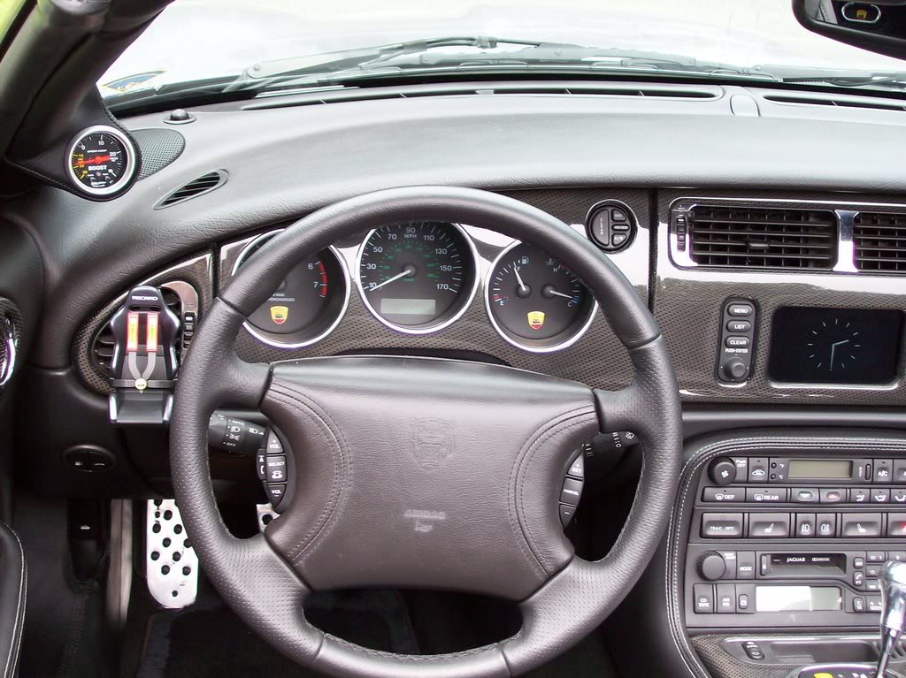

Here is a couple of photos of the gauge I have mounted on the pillar post, the gauge pod is trimmed in leather.

WOW, looks like factory installed, I have seen some awfully horribly looking ones but yours is an exception

Out of interest, what are the badges on the other gauges?

And who sits in what looks like a little mini-Recaro seat mounted at the left air vent?

The badges are Arden logos: http://www.arden.de/en/
I think a cell phone fits in the little Recaro.
