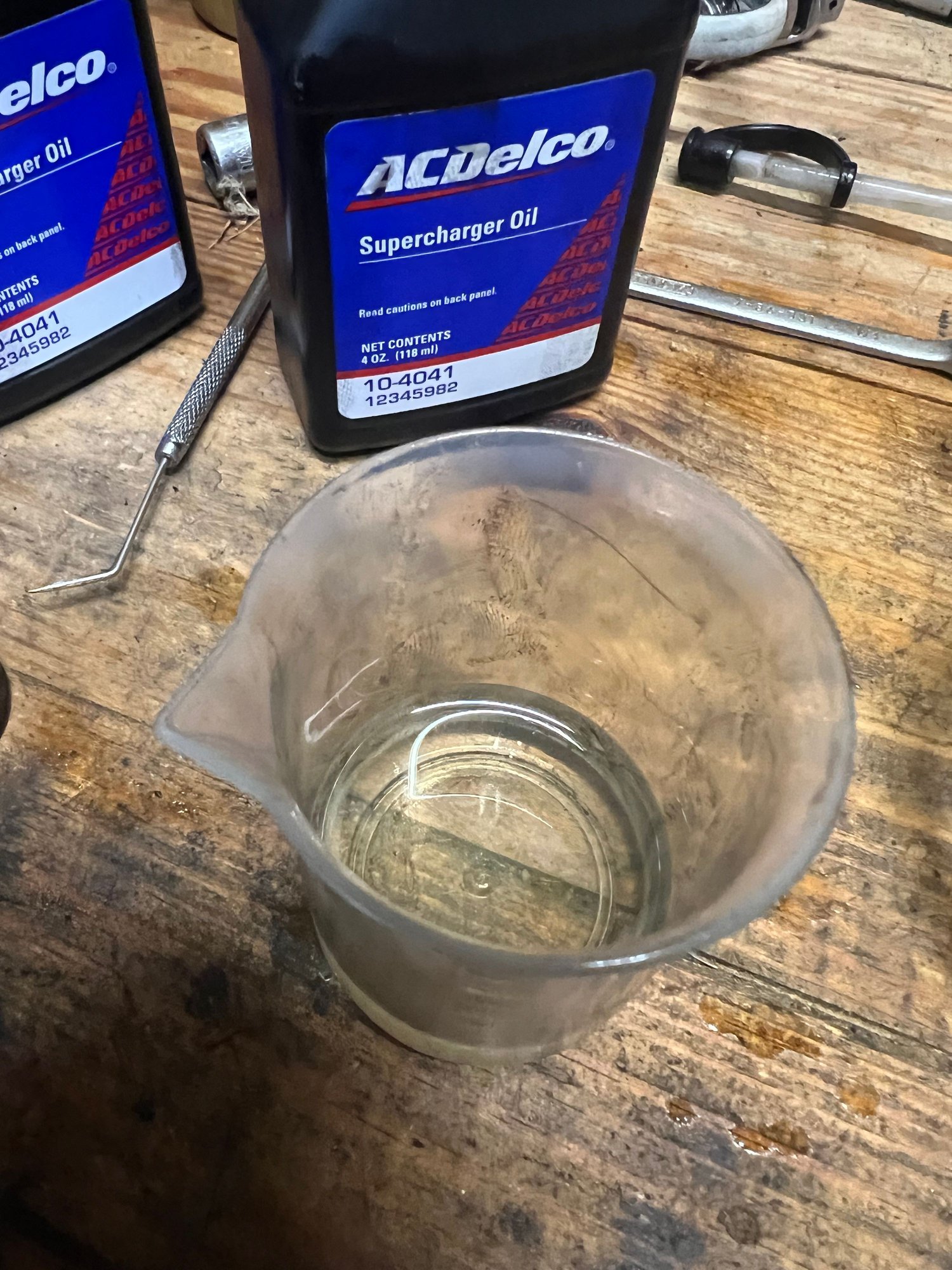

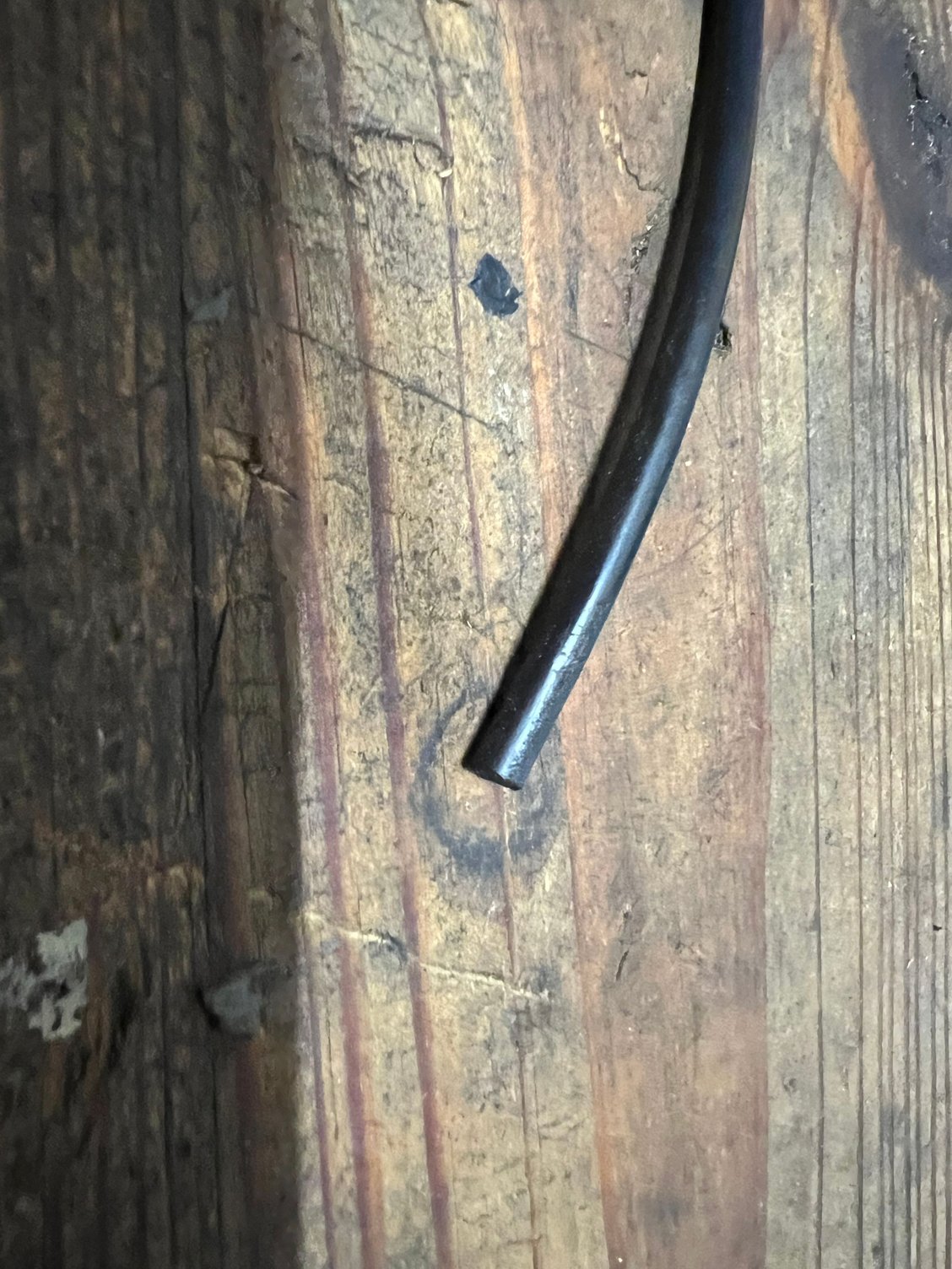

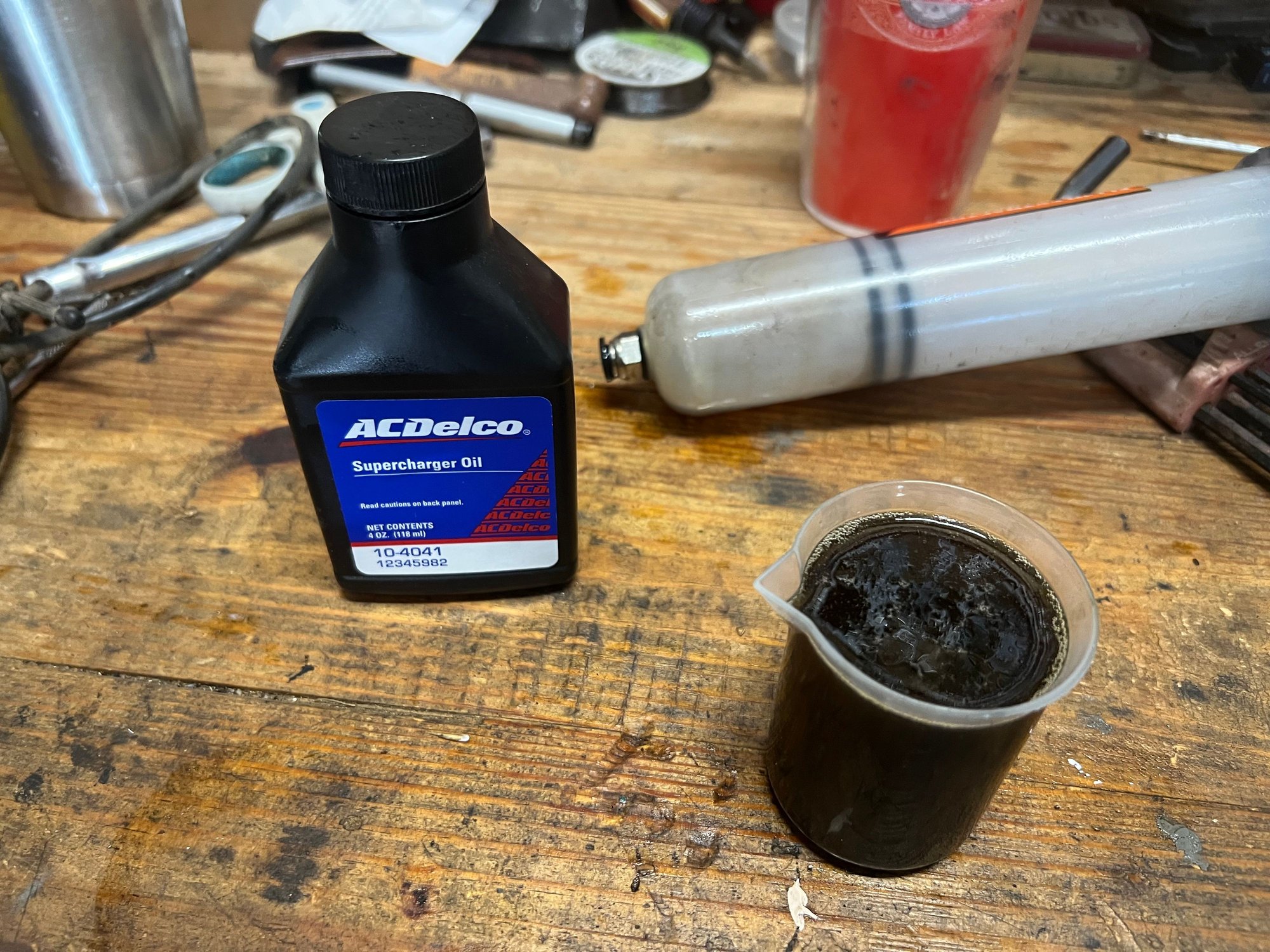

I recently did. Bought the GM Oil that came with a syringe at https://www.ebay.com/itm/324172072236
The hose that came with the syringe was too thick. I found a smaller diameter vacuum hose. When you push the hose in it stops right away. Need to push and rotate until it goes in a few inches. Old and new fluid pics below.
Old
New
The hose that came with the syringe was too thick. I found a smaller diameter vacuum hose. When you push the hose in it stops right away. Need to push and rotate until it goes in a few inches. Old and new fluid pics below…..”
1) Do you recall the diameter of the hose you used? I’d like to find a better solution that the spray can red nozzle that I’m currently using.
2) do you known how long the supercharger oil had been in there ?
Mine looked black the first time I changed it @ car mileage 130,600. As far as I could tell from the car’s extensive maintenance records, it had never been changed before then, and I don’t doubt it.
The smell was not as bad as old rear end lube, but close.
Z
Z
5/32” hard plastic not rubber, lets you twist when pushing.
Bought with 189k miles. No idea if ever changed.
