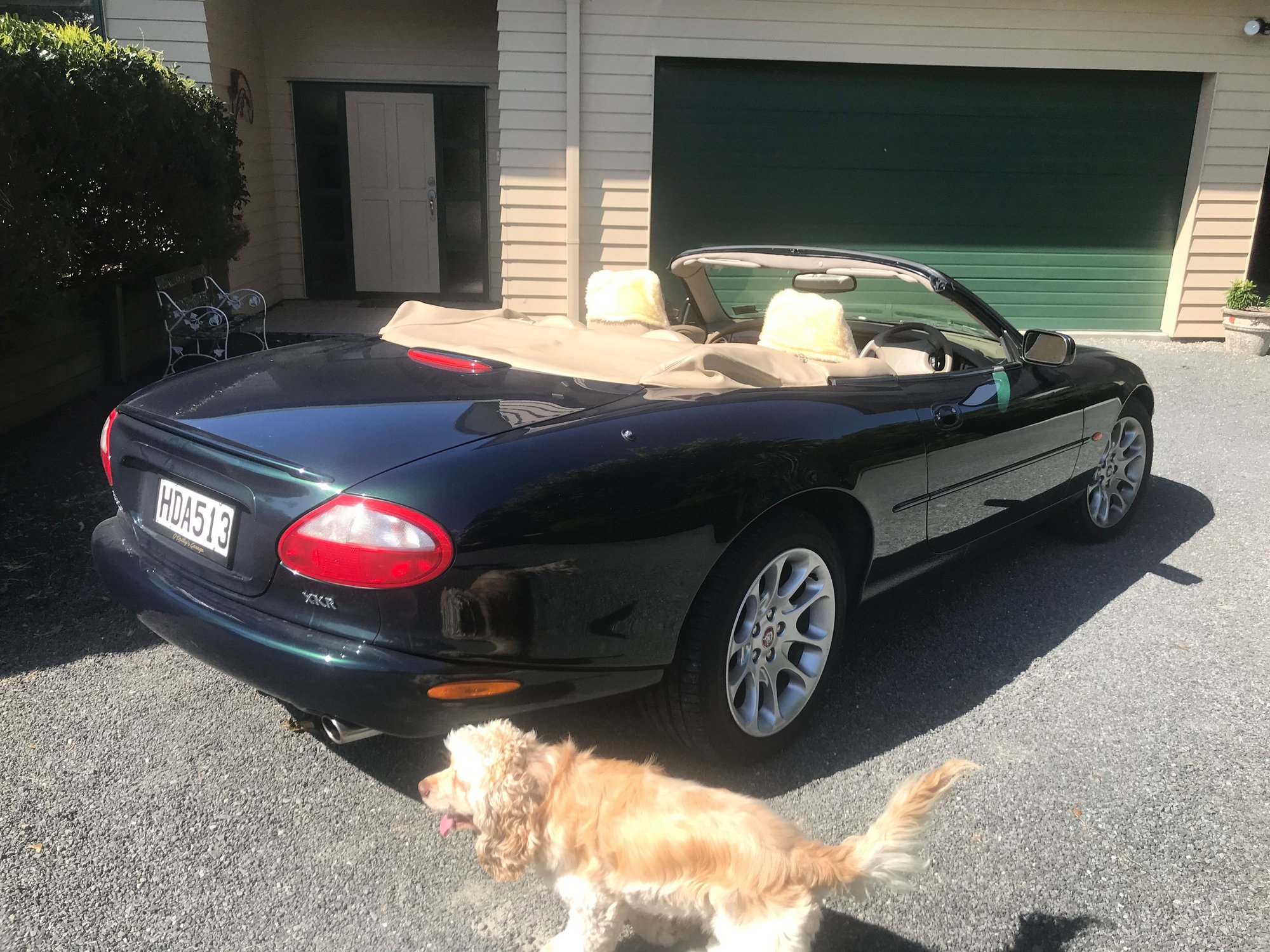

Attached photo is just after I fixed it. It needs a wash and polish but is still lovely.
the dog matches the leather
