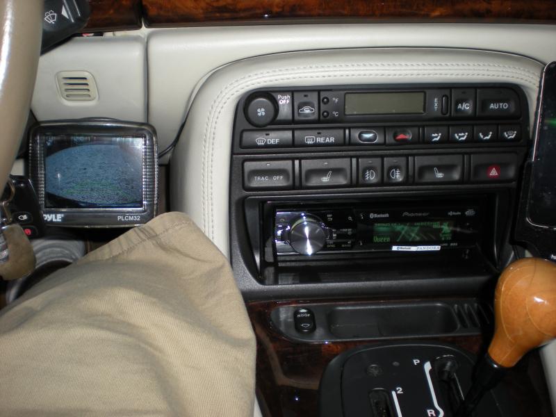

I have a 2000 xk8 with standard radio and cd changer.
I recently changed out radio.
I put in a single din pioneer 9400, cd,bt,sirius xm, pandora and bt ipod controls and 2 usb inputs. I also added a pyle backup camera with a 3.5 screen mounted just next to radio left side on kick plate and also a pro clip iphone holder that charges phone. They also have available other models that can charge and direct connect into radio. I then added a bi pass for the antenna, so its down except when i want to listen to regular radio. I mounted that in the glove compartment.
I ordered a fascia Adapter and a wire harness from Nexxia fp-14 and a fascia plate for an xj8 from coventry west that fits and both adapters make it look more stock. Dont worry about the wire harness, did not need it, it was easier for the shop just to wire radio.
The axxis steering wheel adapter works great and allows for the steering wheel controls to work for your radio.
I can take some iphone pics for you, just pm me with your email if you want to see them. I will post this mod once i get a better camera. I also have a stock radio, cd changer, and wire harness if anyone needs.
Attached Thumbnails XKR coupe audio thoughts-dscn0352.jpg   XKR coupe audio thoughts-dscn0353.jpg
Thanks, I'd love some pictures!
I've been reading up on the single din adapter but cannot seem to understand what the xj8 fascia plate actually is. Can someone post sort of "idiot comparision" of the original and the xj8 one, so that I can see what part the plate actually is?

Thanks to Keithxk8 for the pics, now I understand what the difference is in the facia!

Also some receivers face tilt up to 30 degrees that will make it look even cleaner and flusher
