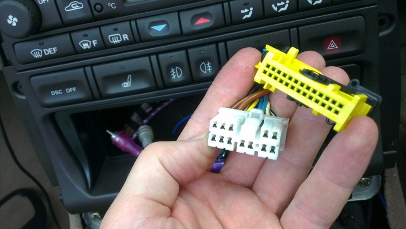

I've just finished my install over the weekend. Had to get a shop to wire up the stereo in the end and they've done a good job, keeping power to my expensive dashboard clock.
I've gleamed a lot of info on this site, many thanks guys for posting all the info. Managed to do most of the job myself, getting the fascia adaptors etc but in the end the iso connectors didn't fit. They had to wire in to the white connector and he foudn the relevant wires on the yellow connector to power up the clock.
I went for the Sony DSX-S300 BTX which has a tray for an iPod/MP3 player and has bluetooth for phone.

I'm just seeing how the bluetooth mic works as it's on the unit itself, so might add on an external mic (any suggestions how to route cable behind dash easily) and poss add on the Sony steering remote for convenience.
Finally I'm also considering fitting a simple Kenwood KSC-SW01 on the floor behind drivers seat. I've already got the RCA and remote on cables route under centre console.
Quick question, what's the best way to route power from amp to battery. Lift rear seat base and is that where the cable hole is for CD changer etc?
Thanks,
Jody
Old Oct 22, 2012 | 10:22 AM
  #30
H20boy's Avatar
Posts: 11,345
Likes: 1,165
From: Oak Ridge, TN
very tidy install Jody, nice job!
In our convertible, the 'hole' for the pass through of cables is on the RHS, just above the shelf, under the carpet. If you can get it through there, you can get it behind the rear seats, and under the seat cushion by removing that one screw under the front lip (unscrew the other on the LHS if you want the entire cushion out), then route it under the carpet up the tranny tunnel. Where is your amp BTW, not in the boot?

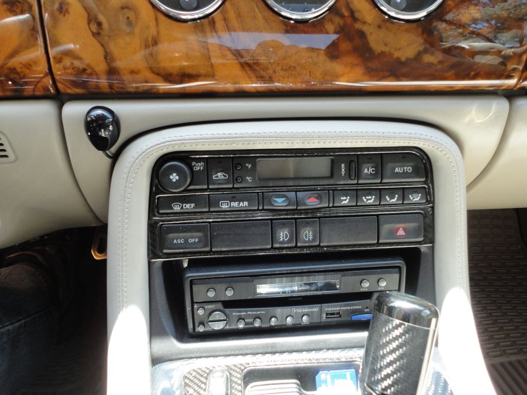

Here are the two ways I did it. First in the '98 XK8 I went with a flip up screen solution to get Nav but found the interference with the gear shift lever annoying (in park the screen hits the shifter when it tries to retract). Second choice was a double din Kenwood relocating the second bank of switches into the glove box. Most annoying part is opening the glove box to hit the seat warmers (California car so don't use the fog lights very often).
Here are the pictures.

Old Feb 26, 2014 | 07:24 AM
  #37
DRettaler's Avatar
Posts: 42
From: Edmonton
Hi,
Thanks for the post. I'm interested in doing this mod. Just a few questions if you don't mind.
For your double din option do you know what face kit they used and how the switches were moved? A custom wiring harness fabricated or the old cut and splice?
Thanks
DR
Old Feb 27, 2014 | 05:56 AM
  #38
SteveJacks's Avatar
Joined: Jul 2011
Posts: 568
Likes: 192
From: Jacksonville
Originally Posted by DRettaler
Hi,
Thanks
DR
I don't know of any faceplates available for double dins that would fit. I made mine. Regarding moving the switches...it took just under two hours to splice wire by wire to extend the factory harness. I cut the connector off leaving plenty of length of wire to work with, and one by one added 24 inches of wire, soldering each end and using heat shrink tube. I do have to open the glove box for some switches, but not a big deal really. For the seats and fog lights, I added the functionality to my car PC using a usb controlled relay board, so from the touch screen I can turn them on/off. But of course that can only be done with a car PC, not a factory double din unit.
Old Feb 28, 2014 | 10:22 AM
  #39
enderle's Avatar
Posts: 2,852
Likes: 703
From: Bend, OR
Default No Kit
Hi,
Thanks
DR
Wire for wire splice and they custom cut a piece of plastic to fit then wrapped it with matching carbon fiber wrap.
