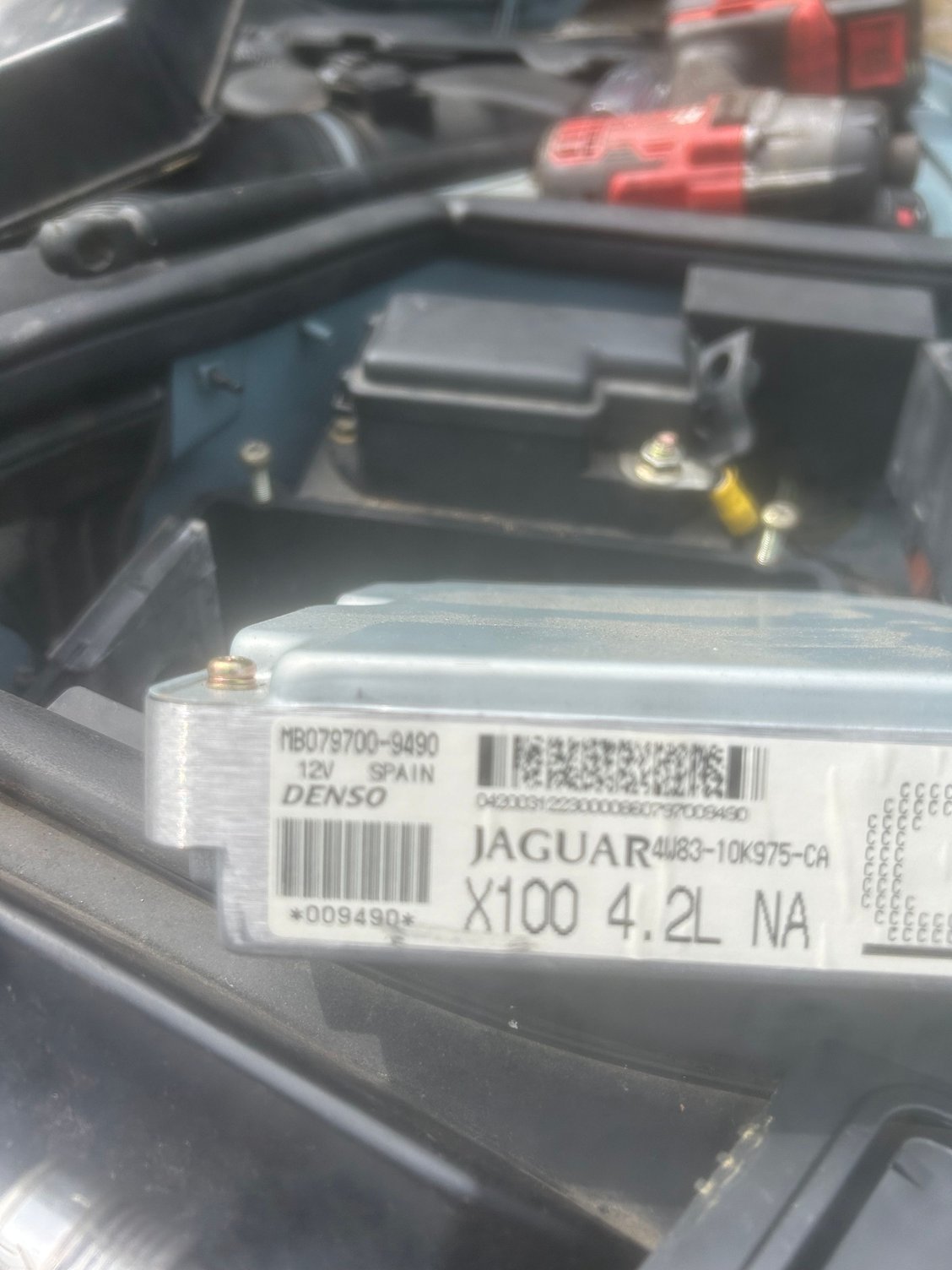

my jaguar was leaking coolant from the cross pipe, replaced that in the water pump. Nothing wrong with the water pump just had to plastic fin none broken, but I replaced them with a metal one after I did that the vehicle would not start getting codes that it won’t communicate with the ECM or the TCM had the battery charged up to 12.5 still crank no start
I’ve checked all fuses and many relays, and if anyone has any fuse box diagrams, that would be much appreciated. Mine in the trunk doesn’t have the diagrams that I’m seeing online any ideas would be much appreciated.

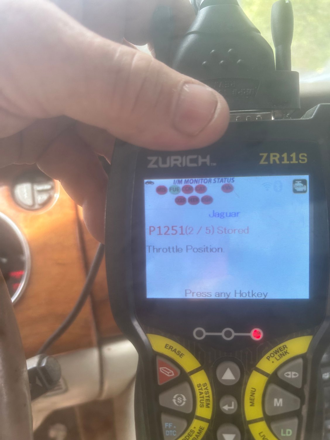

Here are a few codes i got

I replaced the cross pipe and the water pump. It ran fine. I did that, and it never started again.
