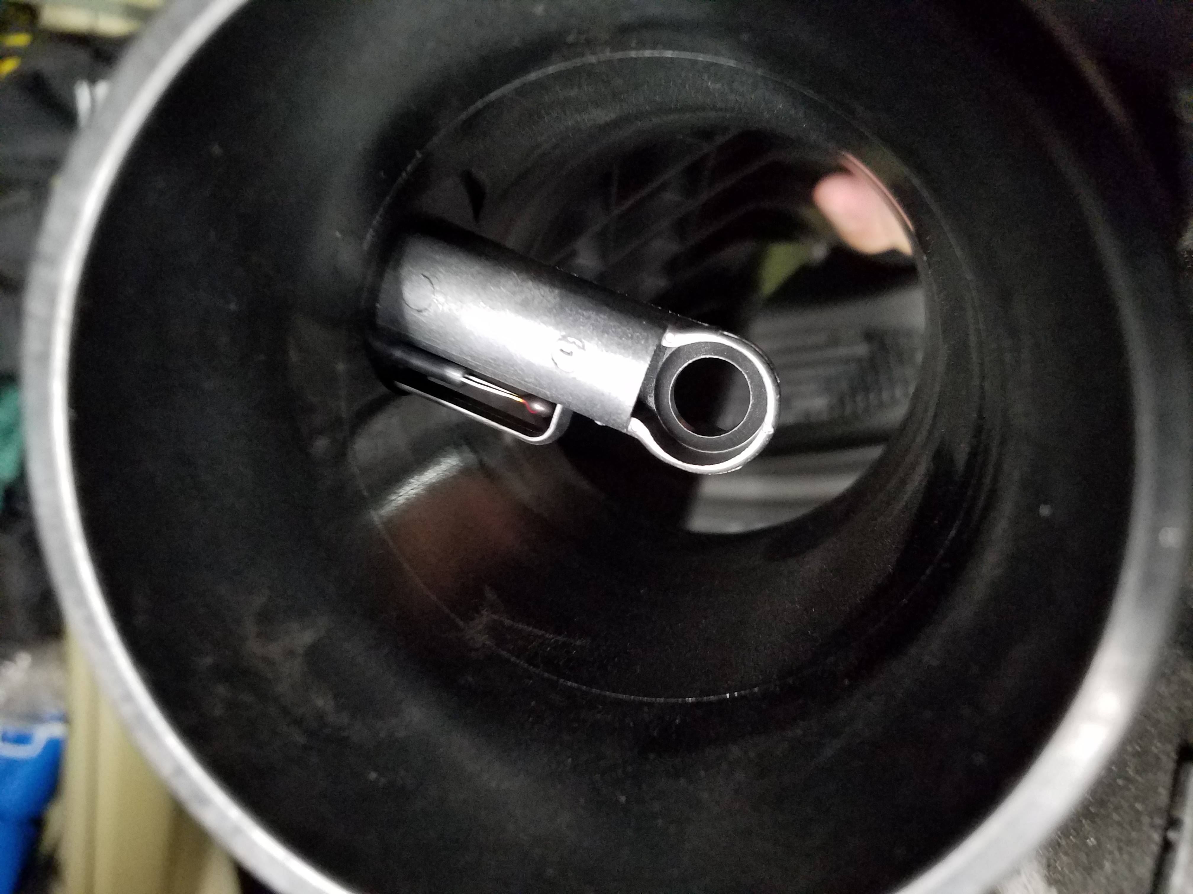

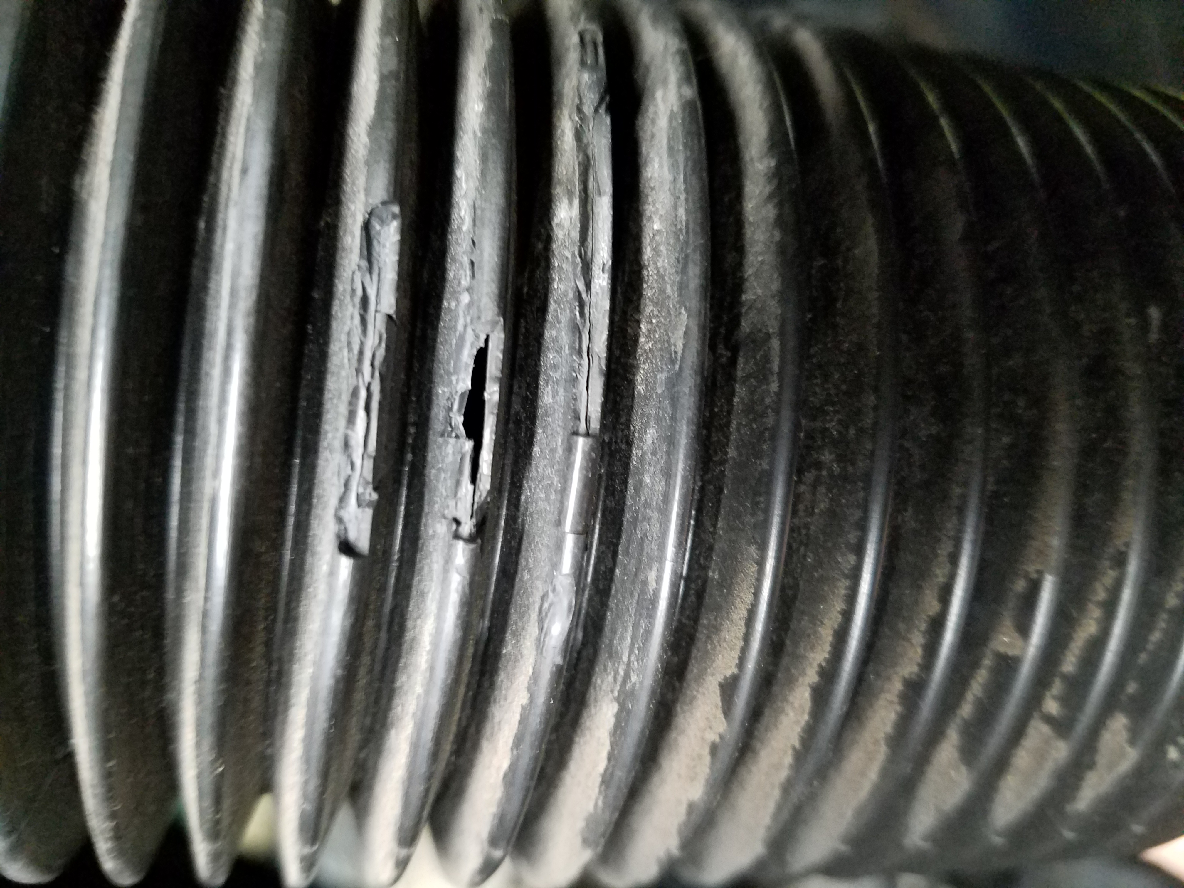

Also i just pulled the air inlet off the throttle body and found several possible issues. One, the throttle body is pretty gunked up, so I'm going to pick up some throttle body and MAF sensor cleaner on way home from work tomorrow. Also, there are cracks and several small holes in the intake tube bellows. In addition, is that an XK8 MAF sensor? I was reading this DIY article and there are definitely two versions (http://matt.zenfolio.com/diy_document_clean_mafs.pdf) but again, no OBD codes have been tripped. Guess I need to go parts shopping.

cracks in the bellows like that are a common cause of vacuum leak, definitely replace or tape that intake.
my xkr MAF looks like yours, you should check the part number to be sure.

Ok, so my LTFT1 is averaging 12.90, LTFT2 about 11.93, indicating the the car is seeing a lean condition it is trying to compensate for. O2 Sensor voltages are averaging about .40v over this range which leads me to believe they are probably OK. So doing more research I need to definitely take care of the vacuum leak in the intake bellows then check for other air leaks, clean the dirty MAF and TB. If still off, check for a weak fuel pump (pressure test) and/or PCV plumbing leaks. Hopefully this will take care of it. Anything else on the XKR that is a common cause of a lean condition?

You are clearly on the right track fixing these air leaks. Those are allowing un-metered air and will force the fuel trims up. Pay attention when you put a new intake tube. Make sure it sits low, otherwise it rubs on the hood liner, and eventually leaks.

As a general statement, use the specific kind of cleaner for the air flow meter. Folks have reported problems after using other things. Also, it looks like these air flow meter/intake air temp sensors are used on LOTS of cars, and can be found (refurbished) CHEAP on eBay.

I think the bellows leak repair will solve the problem. The gasket that seals the intake pipe to the throttle body can degrade and cause a leak, but your trims are not bad so I wouldn't search further until the bellows is repaired.

I cleaned up everything and did a temporary patch on the air tube bellows until the new one comes in, rechecked the fuel trims and the STFT readings went to mostly zero, bouncing around occasionally between +/- 3%-5%. Much better than 18%-25%! Thanks again.
