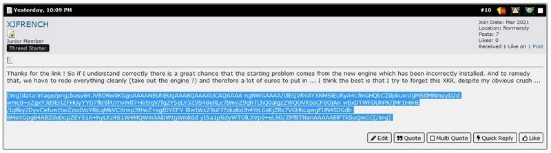

You can't Cut & Paste photos directly to the forums. They appear as a block of code as your post #10:
Use the Upload button to locate the photo on your PC/laptop/tablet and follow the instructions on screen to upload it:
