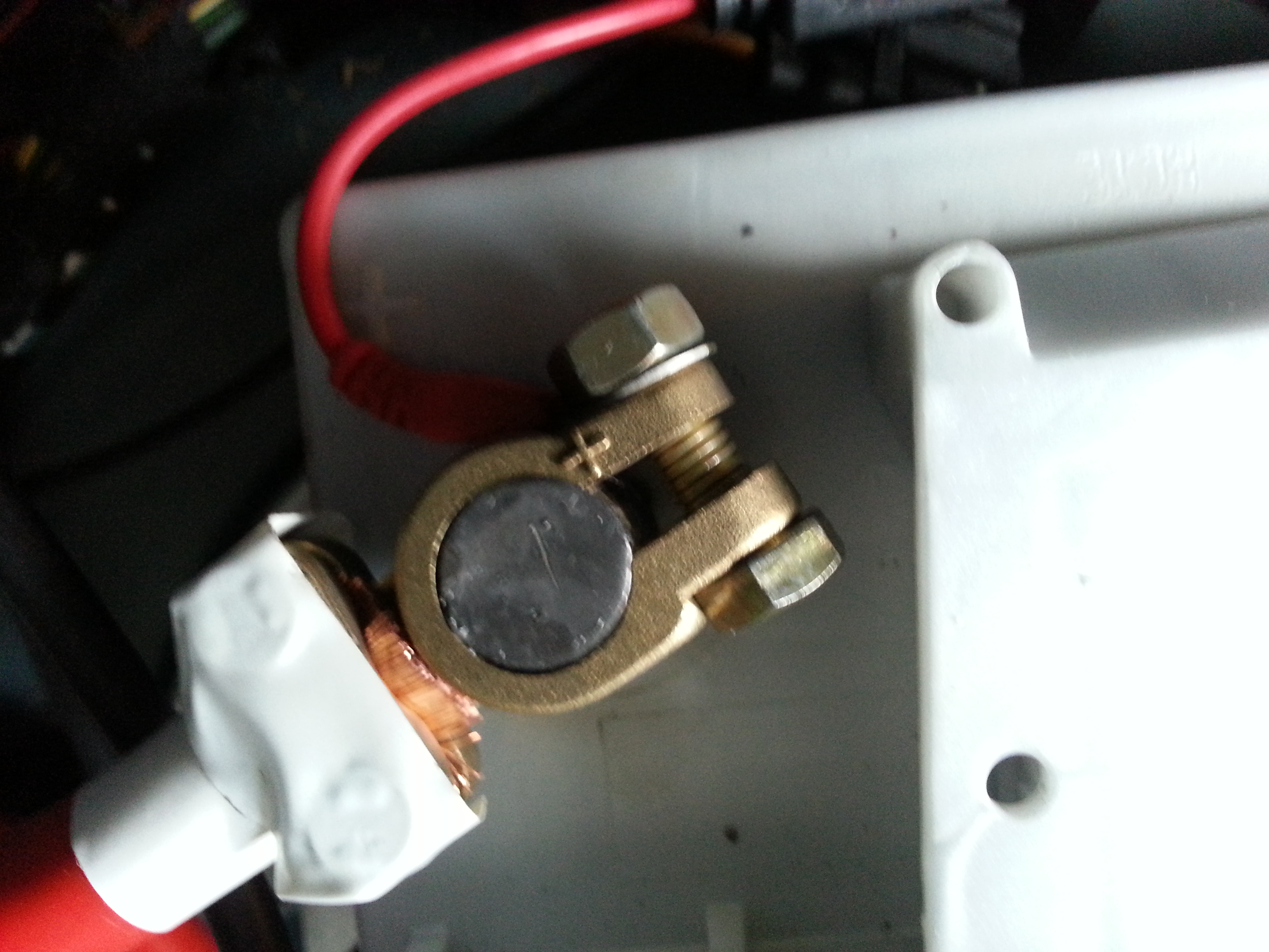

It is not only the braided ground cable that may be your problem.
While tracing a similar problem, I noticed that the red positive cable from the battery to the high current fuses became very hot, 50C (120F). It seems this cable may degrade inside without any visible signs.
It is also a thin walled battery clamp which is not very rugged. Changed the whole with a generic more robust clamp and cable.
In addition, underneath your car approximately where the gearbox meets the engine, you have a braided ground to the chassis. Worth checking.

There are positive connections on the bulkhead fittings in the engine compartment and a ground cable from the right rear of the bellhousing to the frame that often are a problem. Follow the positive battery cable to the two main fuses in the forward part of the spare tire well and make sure those connections are good.
It's often not enough to just check that all these various connections are tight, but that the terminals are clean and free of corrosion.
