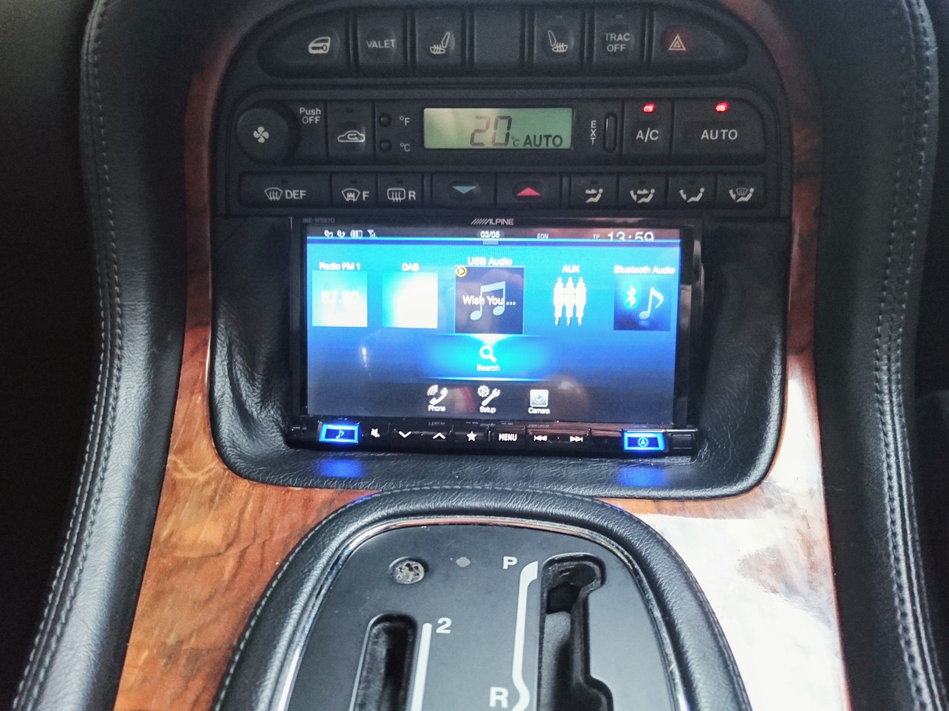

A year on,
all sorted and fitted. Had to clip the connector from the speakers to the amp off and rewire it to my new ALPINE 5ch amp which is connected to the rear of the head unit with phono cables.
Split the front speakers with a crossover box to send correct signals to the door speaker and pillar tweeter.
Rears caused no problems and wired the sub out to the parcel sub.
Trimmed the standard XJ8 fascia down to fit the top of the screen and glued a bit of an old sofa to cover the exposed ribs.
