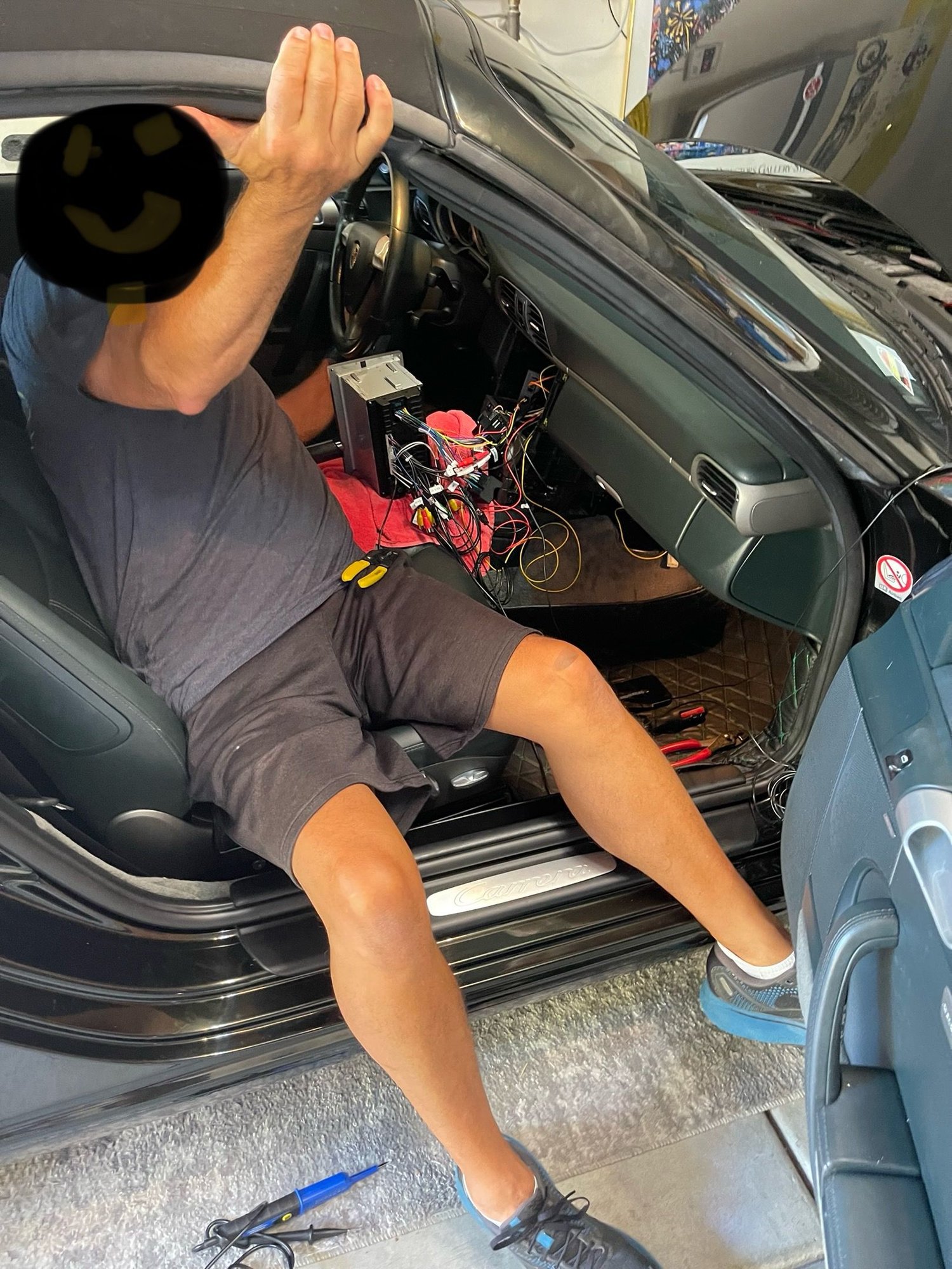

A friend of mine has a 2005 Porsche 911. It uses a MOST network, same my XKR for the audio signal between the head unit, amplifier, etc. He is replacing the head unit with an aftermarket one that has all the latest doodads.
We believe we have everything connected properly, but we aren’t getting audio iutvof the speakers.
The audio comes out of the head unit on RCA plugs. I verified by hooking these to a speaker that audio came out of these. These plug into an adapter box, that connects to the MOST connector that previously connected to the back of the OEM head unit. The MOST network then connects to the separate amplifier. We used bypass connectors to bypass the things like the CD player, and Nav DVD player that are no longer used.
BUT, we aren’t getting any sound out of the speakers. The converter box is getting voltage, but I’m suspecting maybe it is fubar. Does anyone know how to test the MOST fiber signal from the converter box to verify it is working?
Thanks…
BTW…it’s supposed to be plug & play. Looks pretty simple doesn’t it?

Well…we got it working. Instructions said to use bypass loops on the MOST network that goes into the Navigation DVD Unit, and the CD player…which we did. Just for yucks we removed the bypass loops and connected these units back up to the MOST network, turned it on & voila!!!! It works. It’s a very feature filled unit in a DIN configuration. I know the closed we can get with our Jaaaaags, is the Tesla one, which I don’t care for the look.
By the way, feel free to add to this thread, on methods to determine the Most is working…without spending a fortune.
