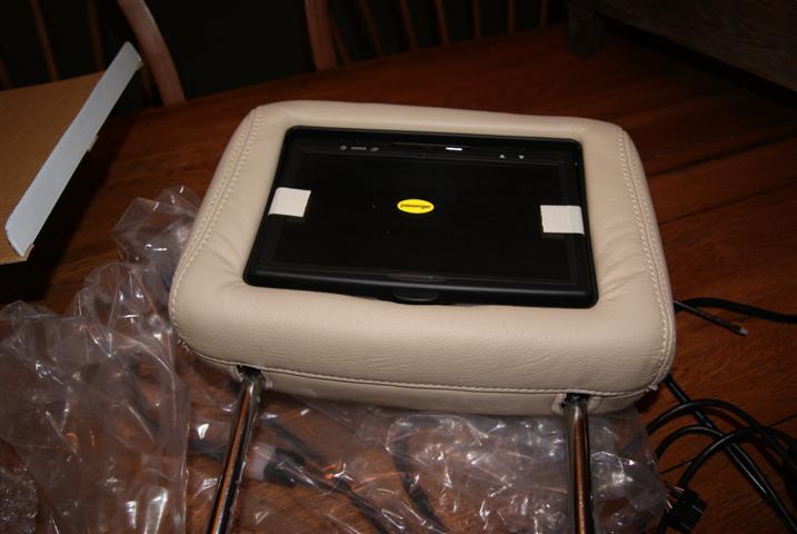

For all the XJ drivers out there who were considering the Nalley kit, it can be done!

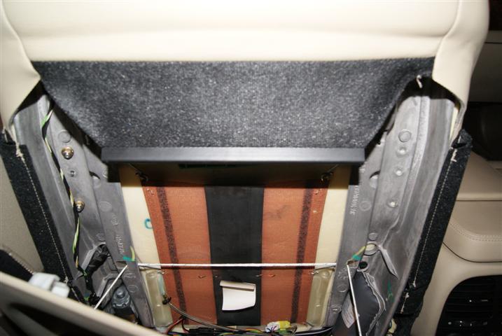

Yes, I hope the pics are a help. I have more of the 'fitting an XType Entertainment kit on XJ headrest frames' pics if you would need to see that process. I had left the electrics/cable runs to a pro installer, so no pics there.
I bought the X kit, but it hindsight it would have been better to go with the S kit as it seems that the S kit headrest posts natively fit XJ seats based on info from albert's XJ install...I dont recall if I bought the X kit because I needed Champagne color or just randomly bought the least compatible kit...
Wires to the console travel from seats to under the carpet and ride the 'hump' under the rear seat bottom and up into the rear armrest. No extensions necessary and power, I am told, came from the rear heated seats. The installer told me that the armrest's plastic tray 'pops' out.
See a closer image of the armrest without all the ipod cabling in the way...
Headrests still work!

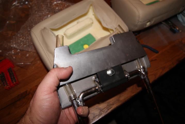

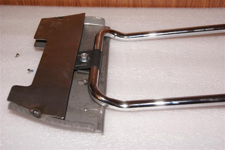

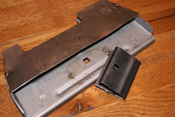

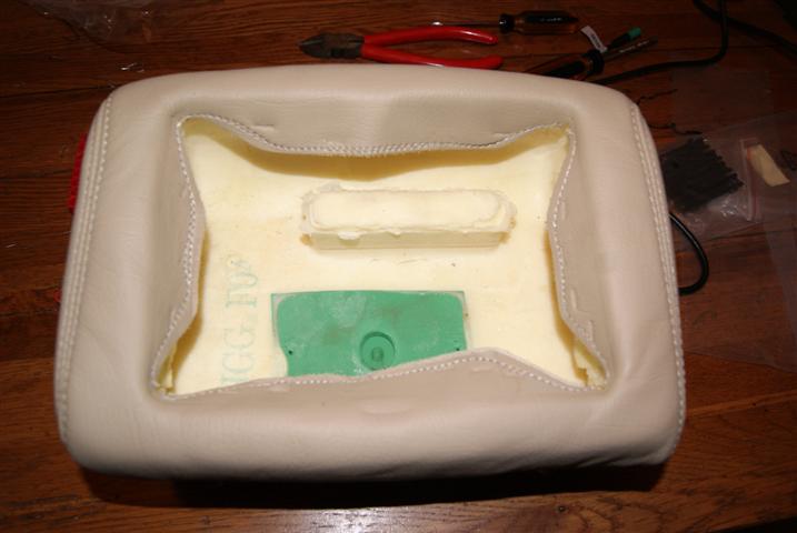

Default Xtype Entertainment Kit on XJ Headrest Frame
Here are the pics of the Xtype Entertainment Kit on XJ Headrest Frame process...
If you have XJ, would suggest buying the SType kit as the process shown here is not necessary as it has been reported that the S headrest kit is a 'drop in' replacement for the XJ....
