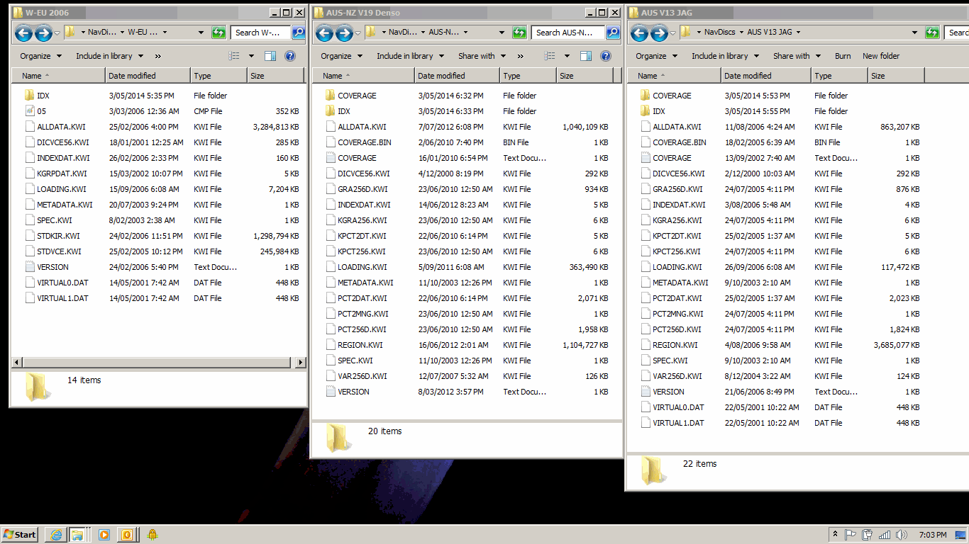

Alright, I finally got a chance to have a look at the Nav discs in detail...
I have three discs available for comparison;
Genuine Jaguar 2006 Western Europe
Genuine Jaguar 2006 AUS (no NZ) V13 from kosta013 (thanks again mate)
Genuine Toyota Lexus Denso 2012/2013 AUS/NZ V19/V8 which I picked up 2nd hand
I also have a Genuine Jaguar 2004 Western Europe disc somewhere but I can't find it right now, it came out of my old X-Type, and did not allow destination entry on the move. I updated to a 2010 in the X-Type, which unlocked that feature, the disc was sold with the car.
Previously in Europe the 2006 Jag disc in the XJR allowed destination entry and other functions while the vehicle was moving. Running the Toyota/Lexus "Denso" disc I lost that feature, I didn't make a software update from the "Denso" disc, turns out it's a good thing I didn't!
So here is a picture of all three discs mentioned above, viewed in Windows Explorer;
Interesting to note that the Genuine 2006 Jaguar disc is all but identical to the 2013 "Denso" disc, save for 2x files, and the size of the files (maps).
Those two extra files just happen to be there in the 2006 EURO disc, so i'd say they are Jaguar-specific files.
What's interesting is the file LOADING.KWI....
This file is the one that is used to resurrect a dead Nav system, as expained in this post https://www.jaguarforums.com/forum/s...99/#post872112
When I looked at the LOADING.KWI file on the Whereis AUS/NZ discs, they are totally different to the LOADING.KWI on the Jag discs, or the one used to resurrect a dead Nav system. On the Genuine Jaguar Whereis disc it's a Toyota/Lexus file!!!!! WTF!!!!
The files and layout of the AUS/NZ discs are totally different to the EURO discs, so it's safe to say that they just took the Toyota disc, added those two extra files to make it work properly with the Jag.
Now, i've been using the Toyota/Lexus Denso disc in my XJR, and to be honest it's never worked as well as the old Euro disc when I was living over there.
So i'm going to make a new 2013 disc out of what we've got here;
2013 "Denso" disc files, but copy the 2x VIRTUAL.DAT files from the Jag disc, and replace the LOADING.KWI with the one from the 2006 EURO disc.
Let's see if this fixes it!
FYI i've looked at all the files you see in that pic using notepad, to try and compare them between discs to figure out what they do and if there might be one file that would be critical for the unlocking of destination entry on the move.
ALLDATA.KWI = appears to be map information
DICVCE56.KWI = illegible data
INDEXDAT.KWI = specific index linking to the data files in the IDX folder, don't mess with this
LOADING.KWI = the actual software to run the touchscreen
METADATA.KWI= language options for the touchscreen
REGION.KWI = appears to be map data
SPEC.KWI = refers back to the metadata
VAR256D.KWI = illegible data
The two VIRTUAL.DAT files are empty when viewed in notepad, but obviously they are specific to Jags, being in both genuine Jag discs...
The IDX folders seem to hold all the info on the Point Of Interests, and the other "extra data" associated with the maps; presumably things like which are toll roads, the average speeds on those roads, etc...
My understanding is that when you load a disc in the Nav system, it checks the version of the LOADING.KWI file on the disc and compares it to the software that is already loaded in there, if the software on the disc is a newer version, it will automatically update. If the software is an older version it won't update, but you still get the functions of the newer software as it's already stored in the nav.
I saw this a few times where I updated the software in friends cars (S-Type, X-Type and X350) with my 2010 Euro disc back in Switzerland, and then when we put the older disc back in, the destination entry on the move was still unlocked.
The thing is, with these Whereis discs, the software version is completely different i.e. Toyota/Lexus vs. Jaguar, so I reckon that it locks everything up as a result.
I will try loading the "new & improved" disc in the XJR tomorrow, and see what happens....

Well, some good news & bad news....
Good news is, the "hacked" disc with 2013 maps actually works, much better than the Toyota/Lexus Denso disc, it's much faster to respond to button presses, and the zoom function is very fast. The responses are just as quick as the genuine 2006 disc I got from kosta.
Bad news, the destination entry on the move is still locked out....
And it still automatically selects toll roads, even though that is supposed to be "off"
There must be some sort of hard coding in the actual map files which locks out entry on the move...
Oh wait, I just realised something...
When I picked up the XJR in London, I took the 2010 Euro disc from the X-Type with me, and loaded that in the car for the drive home (so the firmware was updated to 2010) then afterwards I put the 2006 disc back in, so it was 2006 maps, with the 2010 firmware (already loaded in the car).
So that LOADING.KWI file I copied to the new disc is not the latest one.
And I don't have a >2010 Euro disc anywhere here...
But i'm not sure it'll make any difference to be honest...
