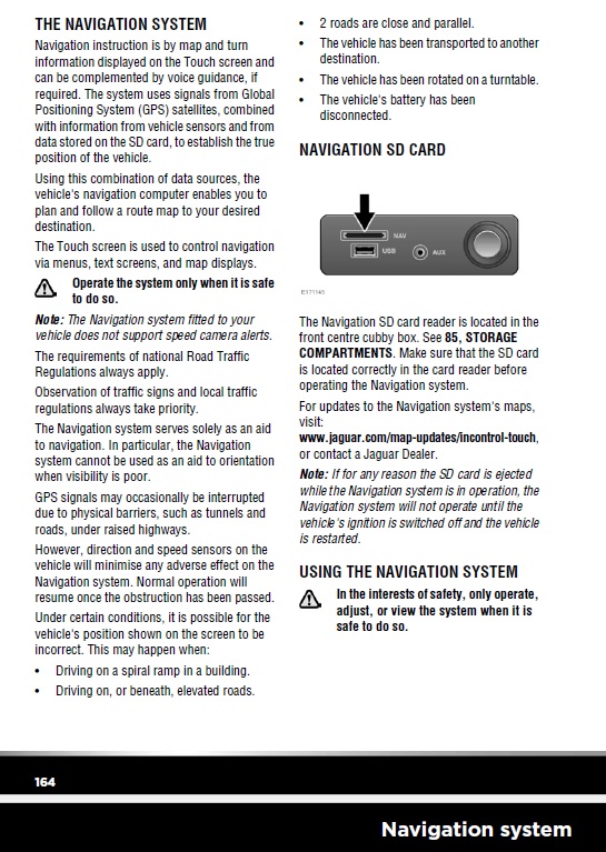

Just curious to know what type of nav system the later and current Jaguar models use? Is it with a DVD? I have just purchased a modern touch screen stereo for my 1976 Triumph Stag and it came with an SD card for the NAV. I would assume I need to keep buying SD cards to keep up.
cheers
