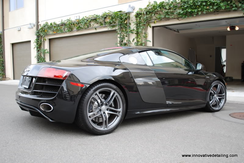

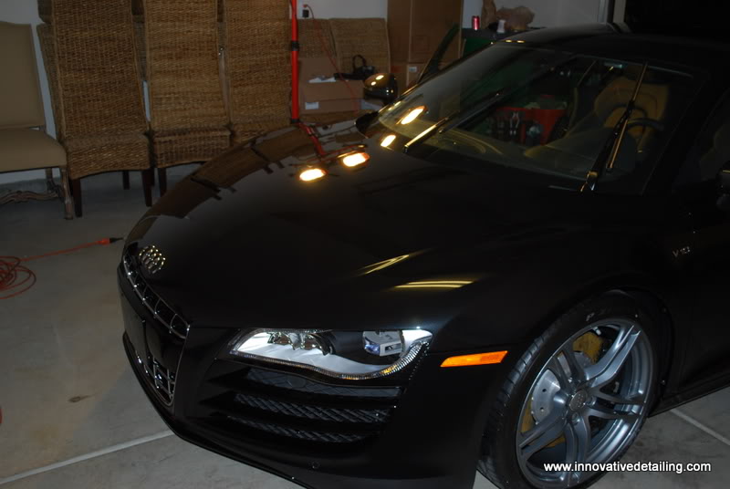

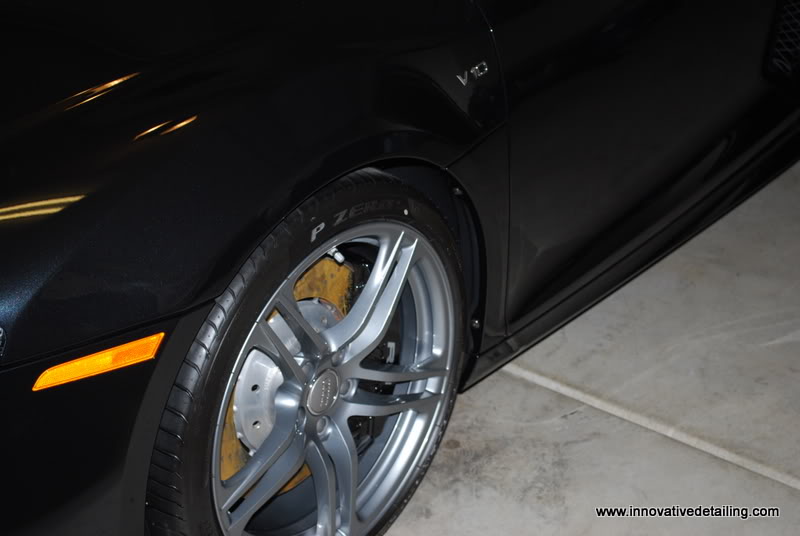

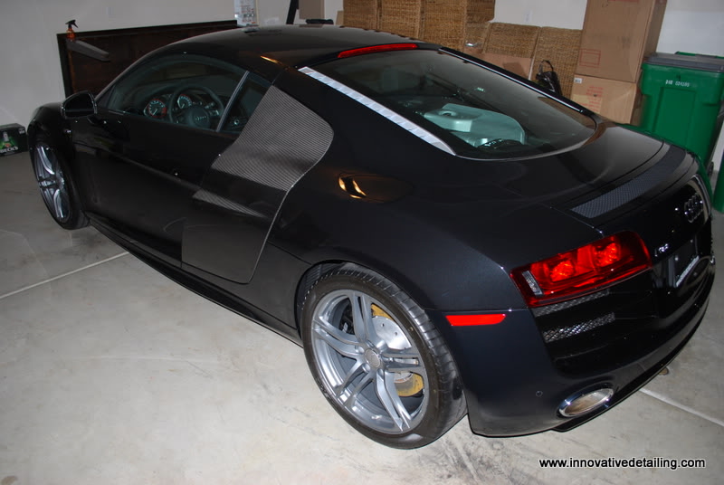

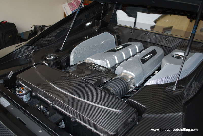

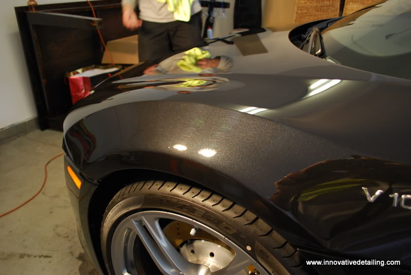

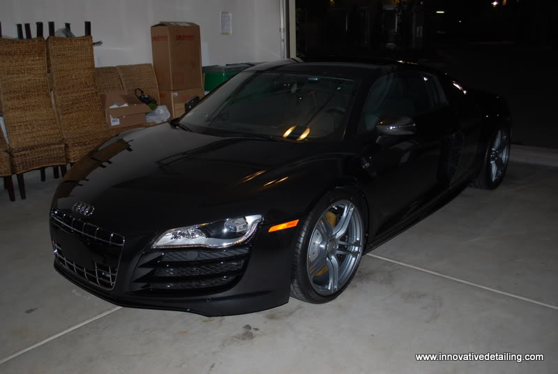

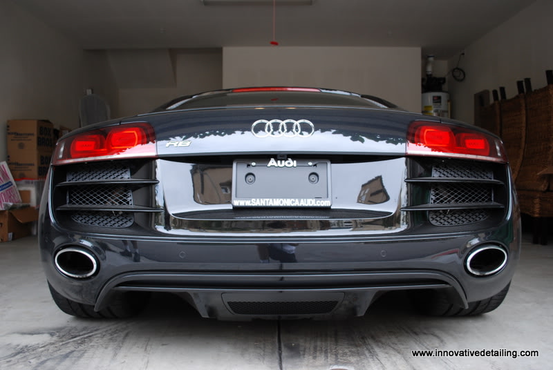

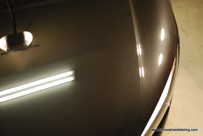

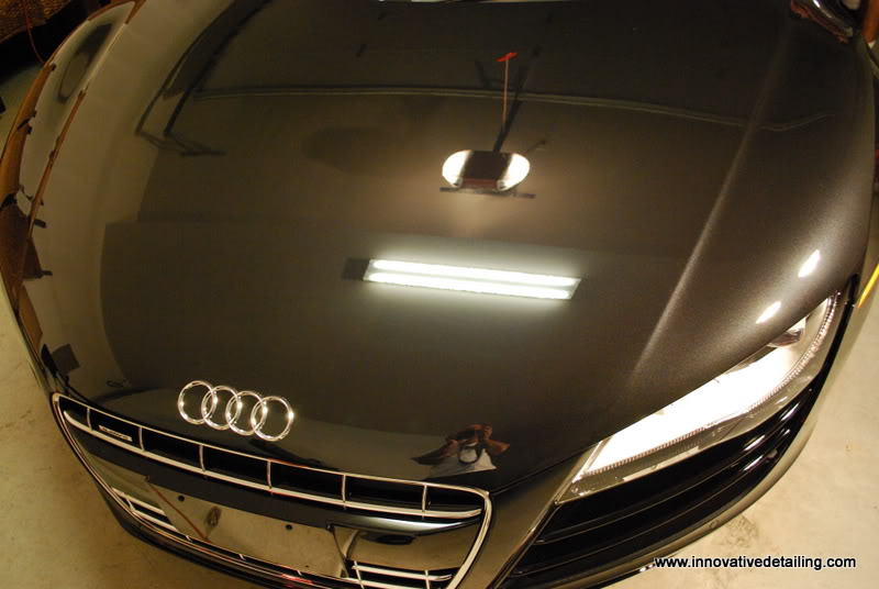

Innovative Detailing along with the Detailing Caddy, Poly's and Meguiar's create a wonderful shine after this Audi R8 is completed. The vehicle had just been purchased 2 days prior and really needed some TLC due to dealer neglect. This 2011 Audi R8 was thoroughly prepped, inspected, corrected and sealed after it's new owner hired Innovative Detailing to do so. In this video you will witness us perform a completely 100% rinseless and eco friendly detail with absolutely no waste water discharge.
The Audi was inspected, prepped, inspected again, then corrected to look the way it should for a vehicle like this one. I could not believe a Audi of this caliber and of this status would be delivered to any customer looking like this.
So it was up to me and my assistant to make this magnificent vehicle sparkle like no other, and make her new owner a proud one.
Exterior procedures
1) Inspect and document
2) Prep with Detailing Caddy and Poly's
3) Dry with SM Arnold Water Sprite
4) Clay all surfaces using "Fine" Blue Clay Magic and Blue Mist

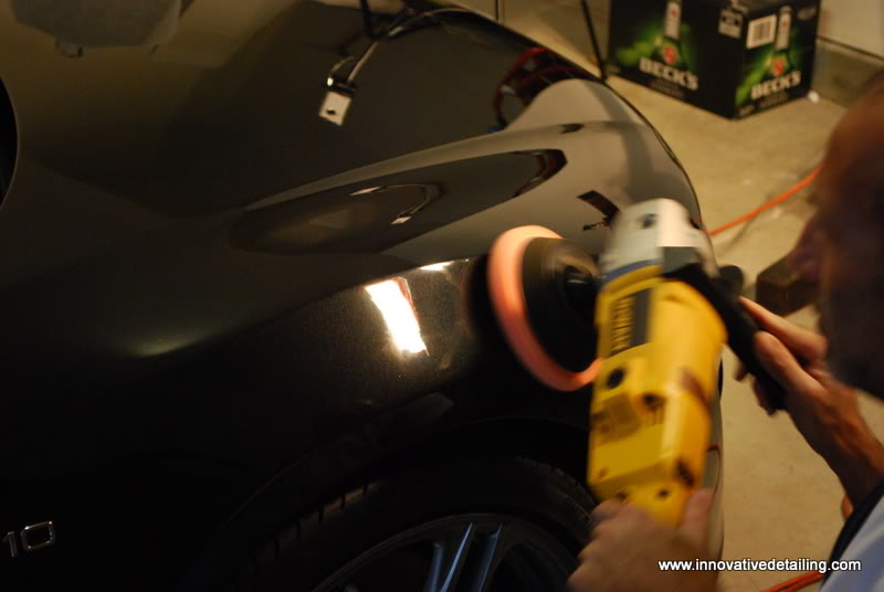

5) Rotary correct using DeWalt and LC 5.5 Orange Hydro pad w/Meguiar's M205 then remove with MF
6) PCXP D/A w/same LC 5.5 Orange Hydro pad w/Meguiar's M205 then remove with MF
7) PCXP D/A w/LC 5.5 Crimson Hydro pad w/Meguiar's M21 Sealant then remove with MF
8) Dust out nooks and cranny's with boars hair brushes to include Jamb wipe down
9) Final wipe with Poly's Clear Tech Detailing Fluid and a MF for my last
touch
10) Treat tires with Stoners Trim Shine
11) Seal wheels w/Meguiar's M21 Sealant
12) Clean and polish glass with Meguiars D120
Last but not least deliver a flawless vehicle to my customer for that "True" new car feeling!

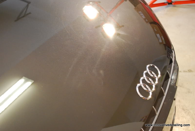

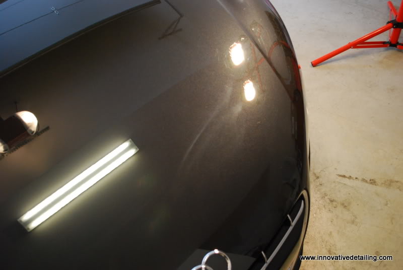

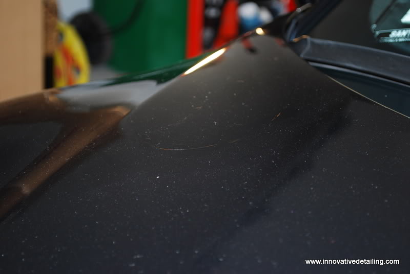

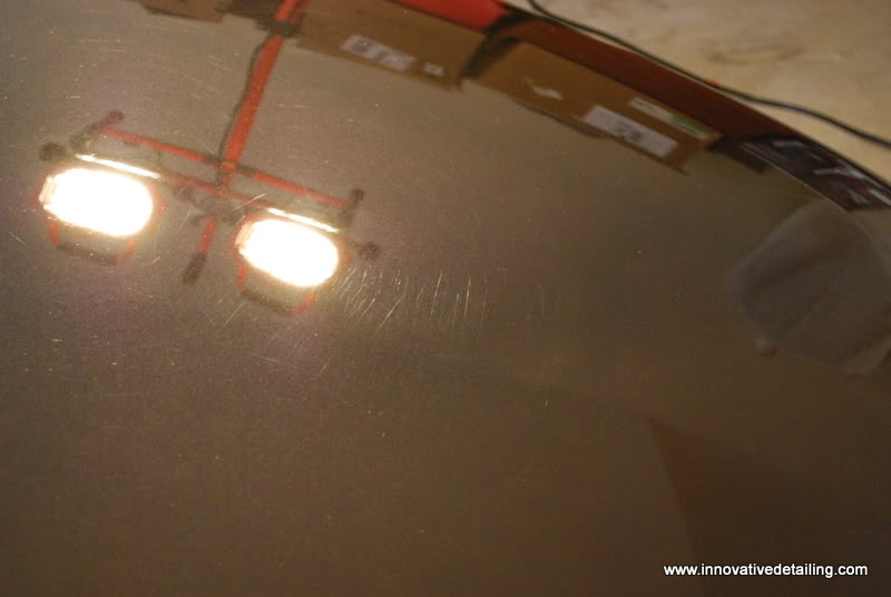

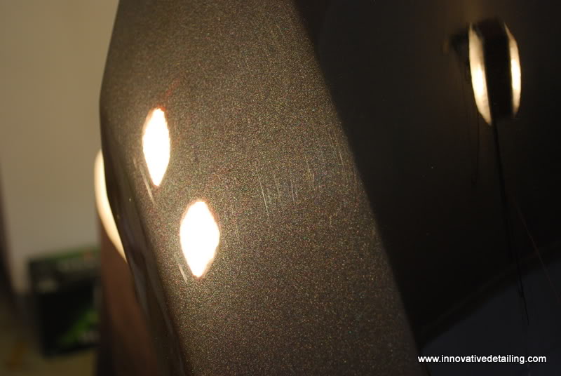

Here is an example of the horrendous holograms, scratches and swirls that were on this beauty Don't they see this stuff at the dealership, or are they just blind...I mean come on guys, I wouldn't even step foot in the finance managers office with this on my car!!!!
