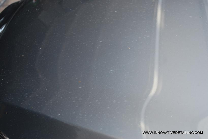

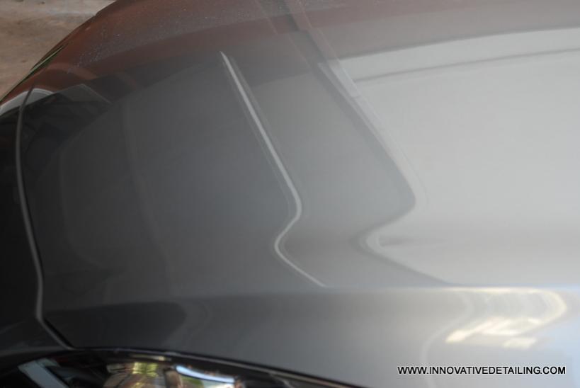

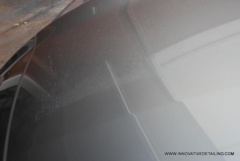

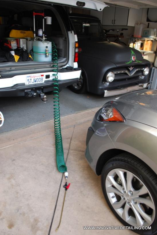

Another option is going with a rinseless system......lately I have introduced this to my line up of services, which also is green or eco friendly and saves on water. If your vehicle does not have a tremendous amount of dirt, this system works great. This is what I made myself and have labeled it the "Innovative 12V Portable Detail Blaster". It plugs into my 12V recepticle and has a 50ft hose, inline filter, brass wand and tip for an atomized application. It has an on/off toggle switch, the system works on demand and delivers from a fine mist to a stream.
With a 5 gal container of water and an ONR premix (3 oz of ONR and 1 oz of Blue Mist) I am able to wash between 8-10 vehicles and leave them sparkling.
Working on a cool surface in the shade is ideal, but it will work in direct sunlight as well. I mist either a panel at a time or half the vehicle at once, to include the glass. Using 2 very plush MF towel folded in fourth's, spray one of the towels lightly with ONR solution on both sides. Then using this towel, wipe a panel at a time flipping the towel to a cleaner surface constantly. Then using the dry MF wipe the panel for residual to flash dry and you are left with a sparkling and clean surface. After every panel I wring out the wet MF towel for best results.
To top it off I will go around the vehicle quickly with just the Blue Mist for total gloss and depth enhancement.
