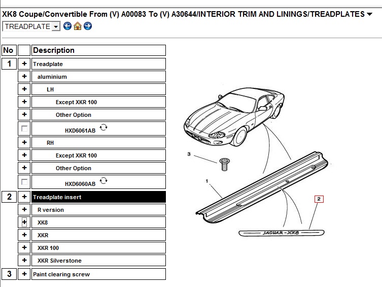

Old Mar 17, 2013 | 07:17 PM
Likes: 17,015
Originally Posted by 9mileskid
Are the sills interchangeable? the passenger one is still very nice while the driver's side has all the scratches...
The Treadplates (item 1) are different for LH and RH but the Inserts (item 2) are interchangeable.
