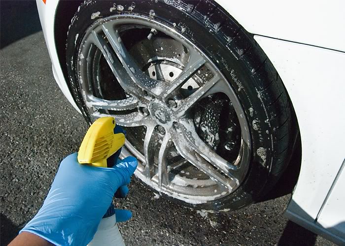

Applying Autoglym Custom Wheel Cleaner.
Anything non acidic to clean your rim is best and one thing I love about this cleaner is it's ability to pull dirt out of the tire very well and with some agitation you can turn a brown tire back into black which is great for later on when you apply the tire dressing. You wouldn't wax a dirty car would you? But yet a lot of people dress their tires while they are still dirty not realizing brake dust gets on the tire to.

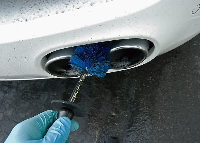

Used my mini EZ Brush to clean in between the dual exhaust.

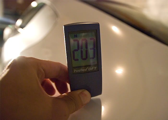

Moving along I measured the paint to look out for any low spots or if anything had been repainted. I found the paint to be fairly thick with every panel being 170 microns or more with the average being about 200 microns. I found it funny that a stone chip I noticed still had paint in it instead of exposed metal, just to give you an idea of how thick the paint was as well Audi paint is known to be rock hard so that helps to.

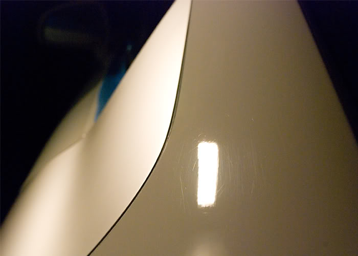

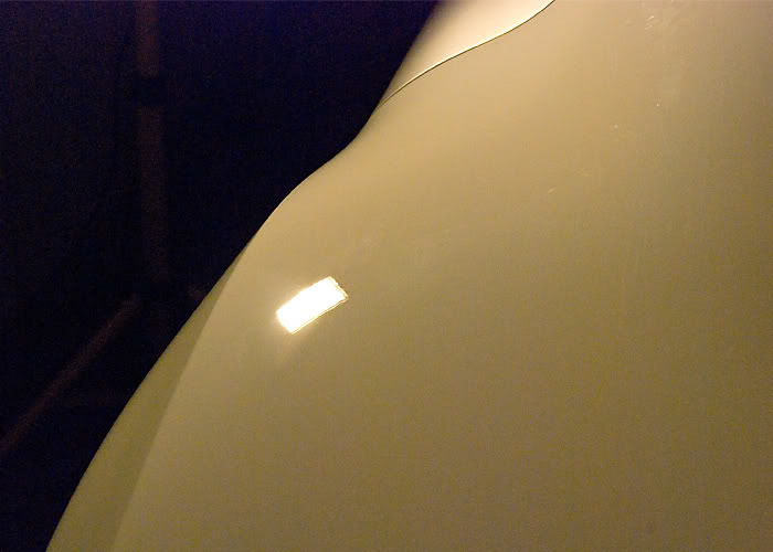

I was hoping to just 1 step polish the paint but with Audi paint being rock hard I had to 2 step it to correct the swirls and then to jewel the paint to a high gloss.
My process for the first step was Meguiars M205 with a Lake Country orange pad on the Makita rotary and here are the results I was getting.
Before
After

Before(I don't know what happened here, but it looks like brillio pad work)
After

Before
After

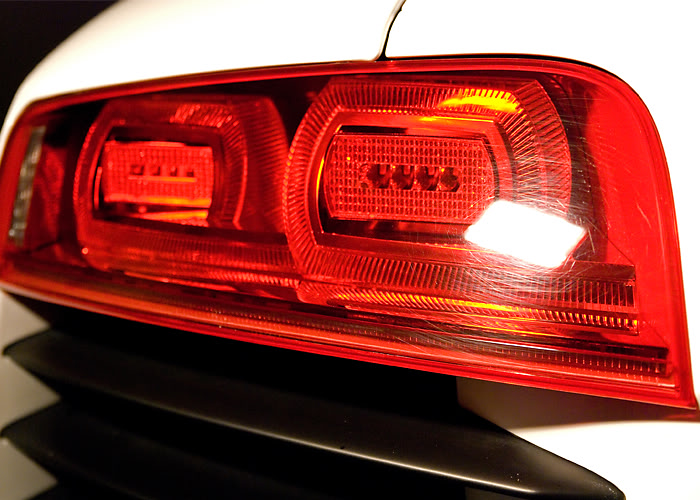

The tail lights were even swirly so I gave those a polish to.
Before
After(this was after one hit, to correct it better it required a second hit)

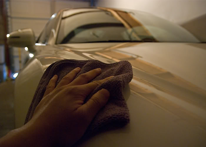

I gave the car a wipe down with ipa alcohol cut 50/50 with water and then jeweled the paint with a grey 3M backing plate, a white Lake Country pad, and Menzerna PO85rd.
Here is a shot of me jeweling the paint.
