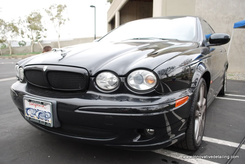

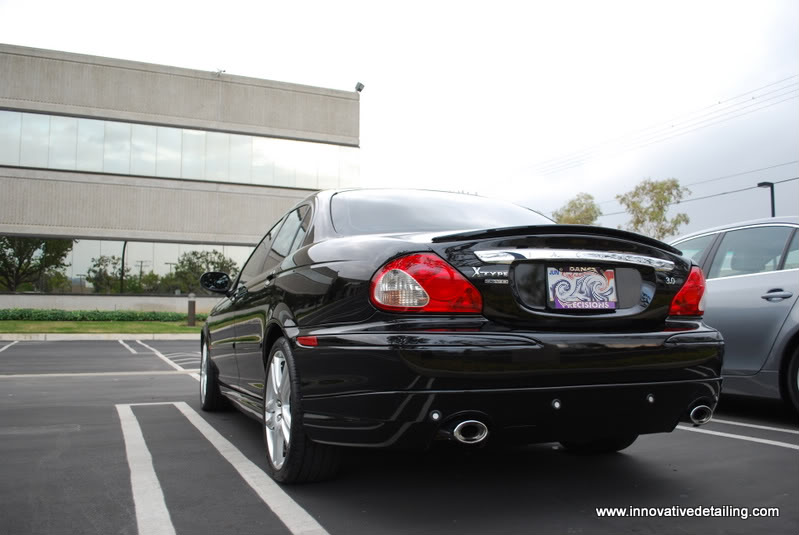

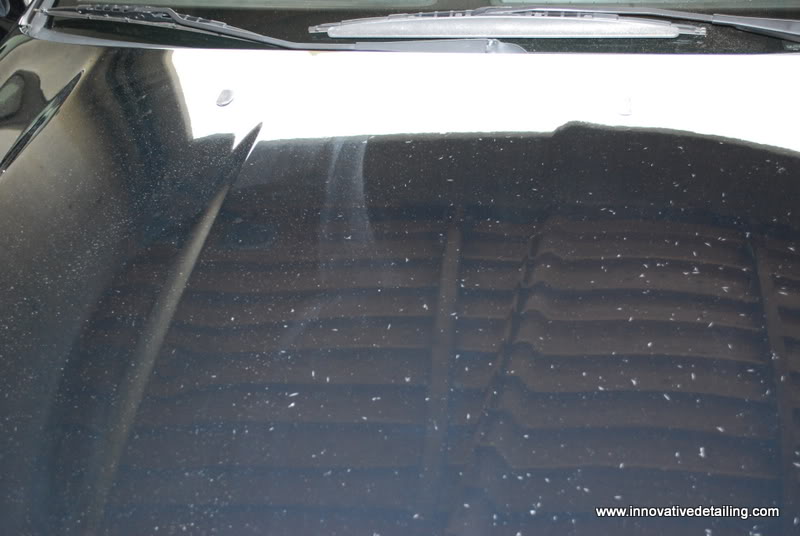

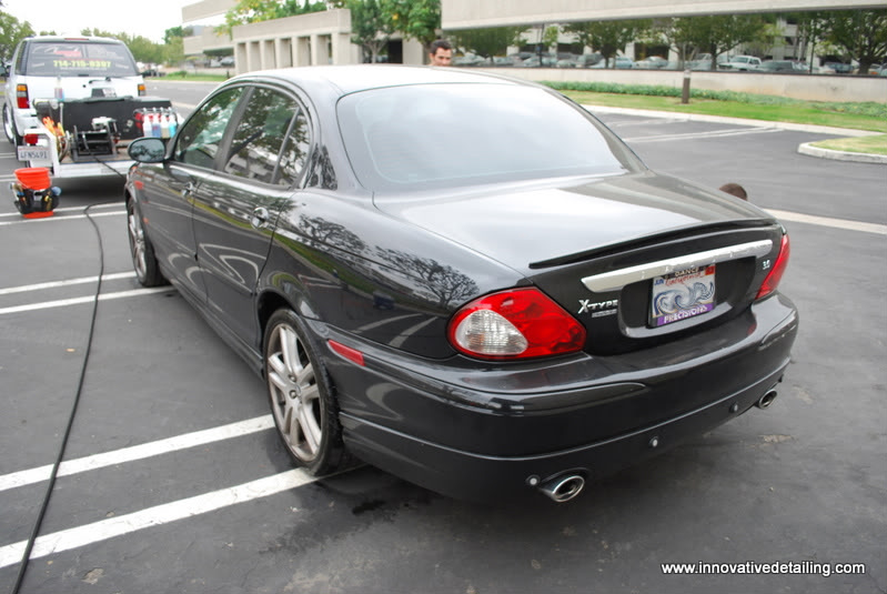

This particular Jaguar X-Type had been cared for by various detailers and included a period of neglect. I was called out to perform my services, which many times includes being a "Detail Detective" to try and find out why something has failed. After conducting a thorough prep on this vehicle, I contacted the owner so we could go over the vehicle and address this Jaguars needs. Boy was this lady surprised when I had informed her that her Jaguar was suffering from the begging stages of paint failure. Sure enough, all of the tops of this baby Jag were 'Checking" and it was sure to only get worse over time. The next question I asked her was if she was the original owner? which she answered "yes"...The next was have you ever been in an accident or has the vehicle been repainted? she saind "no" so I pulled out my paint gauge meter which confirmed factory readings......

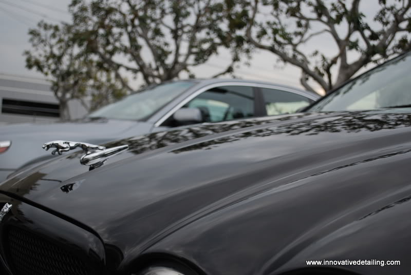

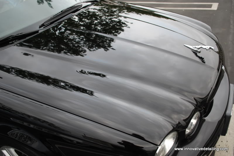

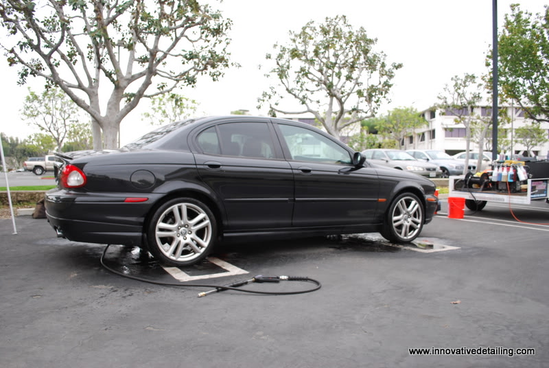

So this is where this detail begins, an attempt to make this Jag come to life within my powers.......So with my son, my cousin and myself we started this project as the weather was not in our favor.......but it all worked out!
All I can say is it's so important to keep your vehicle clean and inspect it regularly to avoid what your about to witness.

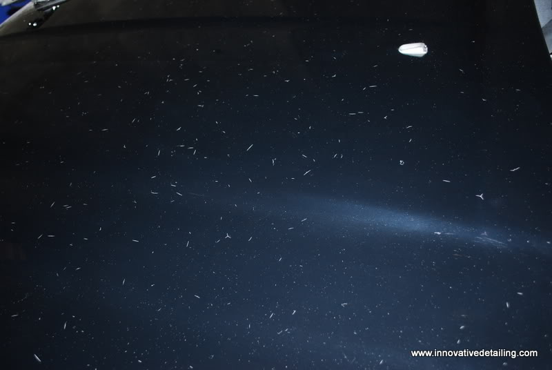

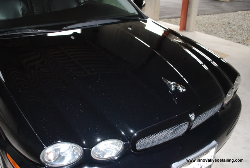

This is some shots of all the damaged tops due to paint failure "Checking" that the owner never noticed

After shots of this X-Type as we did our best, but she needs some paint work...

Although in the final shots you will notice that the paint condition is not so visible in the daylight shots. This is also because the polishing and the LSP hides some of these defects so the naked eye doesn't see it as much.
Fast forward, my client filed a claim with Jaguar NA about this paint issue to see if it could get resolved on this level since the local dealership told her it was out of warranty....I haven't heard from her since......
