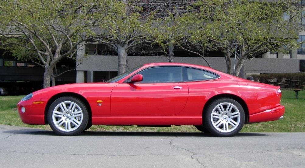

'06 Jag XKR Coupe Salsa (red). The paint is in good condition...I think. Has some very fine scratches and swirling....no hazing that I can see. It's not a garage queen, I drive it every day. But I try to keep it in good condition with washing and waxing. I have a d/a and I want to remove the scratches and swirls. I'm gonna wax it with Zymol Titanium.

In my arsenal I very often use Meguiar's M205 to eliminate, not cover up the scratches and swirls that you are telling me about on your Jaguar. I am not sure what type of D/A you have, or the types of pads that you have since there are so many choices out there. I would recommend using a polishing pad, something like the Meguiar's W8006 which is a medium density pad or a similar variation thru another manufacturer. I also like the white LC pad for this step. Then follow up using the D/A, a finishing pad...I like the blue LC pad and your Zymol Titanium.....if it can be machine applied. If not follow manufacturers directions for applying Zymol....
P.S. Always clay surfaces first prior to polishing on a clean just washed surface......
