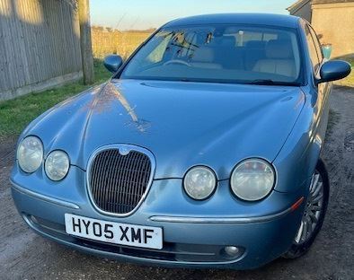

Thanks for letting me join. I have always wanted a Jaguar. It needed to be good value. I went for an S-type 2.7lt V6 Deisel. It's 56K miles 05 plate. I bought it from a trader in Axminster. Fresh MOT, new boots all round, seviced and they gave me 50 quid off so I could put some fuel in it. I got it for £2435. Amazed at the fuel consumption. I made it all the way from Axminster, Devon back to Oxford on around 27 quid of deisel.
