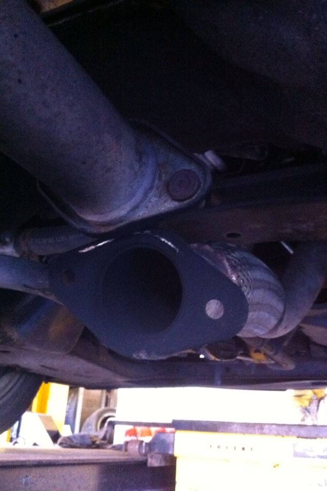

I had the car done, and on picking up the car - seemed fine. The car had a slight exhaust rattle after the repair had been completed, and took it to my local exhaust place a week after I had the work done and they found the exhaust was not fully connected up, it was together but just resting on the bolts, causing the rattle and was obviously not air tight. Can anyone tell me if the attached picture shows exhaust which pipes would have needed to be disconnected by the garage when they replaced my Turbo?

i doubt being disconnected would have caused a issue. what you may be experiancing now is all the oil the collected in the exhaust downstream of the turbo is now being heated and burned up causing the smoke. and therefore should begin to diminish with time. But do check the oil level and make sure it is not going down as a result of a seal failure in the new(remanned) turbo
Would the aghast have had to be disconnected at this joint when doing the repair work listed? I need to know if this was left like this by the mechanics who did the work on the turbo....
