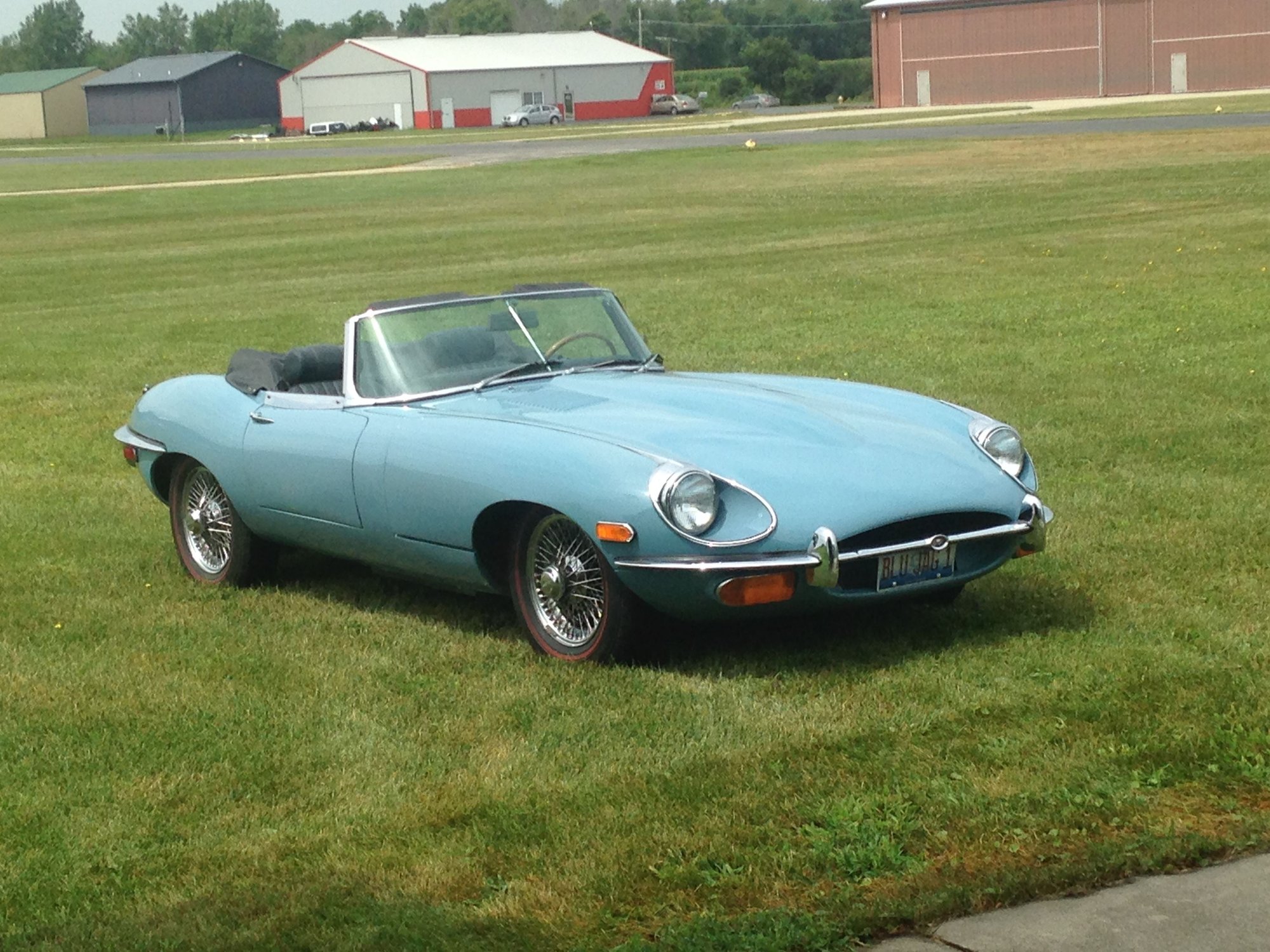

I have a '69 6 cylinder that just rolled into my garage. Was my dad's car. He and his buddies decided to put a 123Ignition distributor in and then couldn't get it to run. They got disinterested in it and it sat in the back of his hangar for a year so I drug it home.
The first thing I found was that the fuel pump wasn't working. Replaced that, swapped fresh gas, traced the wiring to insure the ignition wires went the right place, noted that the rotor is in the correct general position for TDC on #1. I pulled the #1 plug and held it against the block while turning on the ignition. I get spark twice and then no more. Same for the next plug down.
Coil? Bad battery?
Thanks in advance,
Steve near Chicago.
