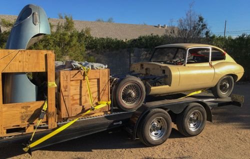

Not my first E-Type refurb.....although this is the first time I bought an unassembled car. I'm sure I'll be asking a lot of questions along the way. Such as, is there any new tech for paint stripping? Ive read some previous posts about sand blasting, glass beading, chem dipping, vapor blasting, etc......many posts noted mixed results. I'm curious what lessons learned / advice everyone may have.

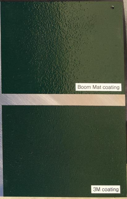

Thanks for the replies. I used the 3M product on my last restoration and agree it worked well. Have also used "DEI Boom Mat". Neither has a huge amount of buildup and both take top coat very well. The Boom Mat tends to look a little more glossy after paint and has a larger "grain" size.
