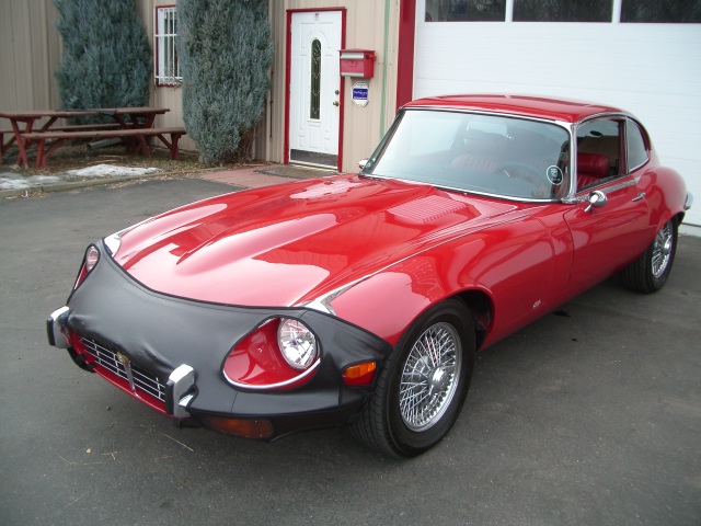

Here's a photo of car. I'll get some closer wheel pix soon

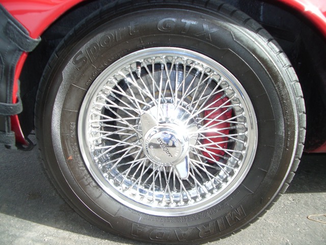

Here's my knockoffs.
Do you know what parts you have to takeoff and change out besides wheels?

Looking at this thread and see you have a bra ....could you tell me where you ordered this from.
thank you
simon
Old Mar 16, 2018 | 06:02 PM
enderle's Avatar
Posts: 2,852
Likes: 703
From: Bend, OR
Be aware that one of the reasons you don't see bras that much anymore is they fog the paint and can wear through the clear coat. You'd likely be far better off with a clear bra (basically a clear wrap for the front).
