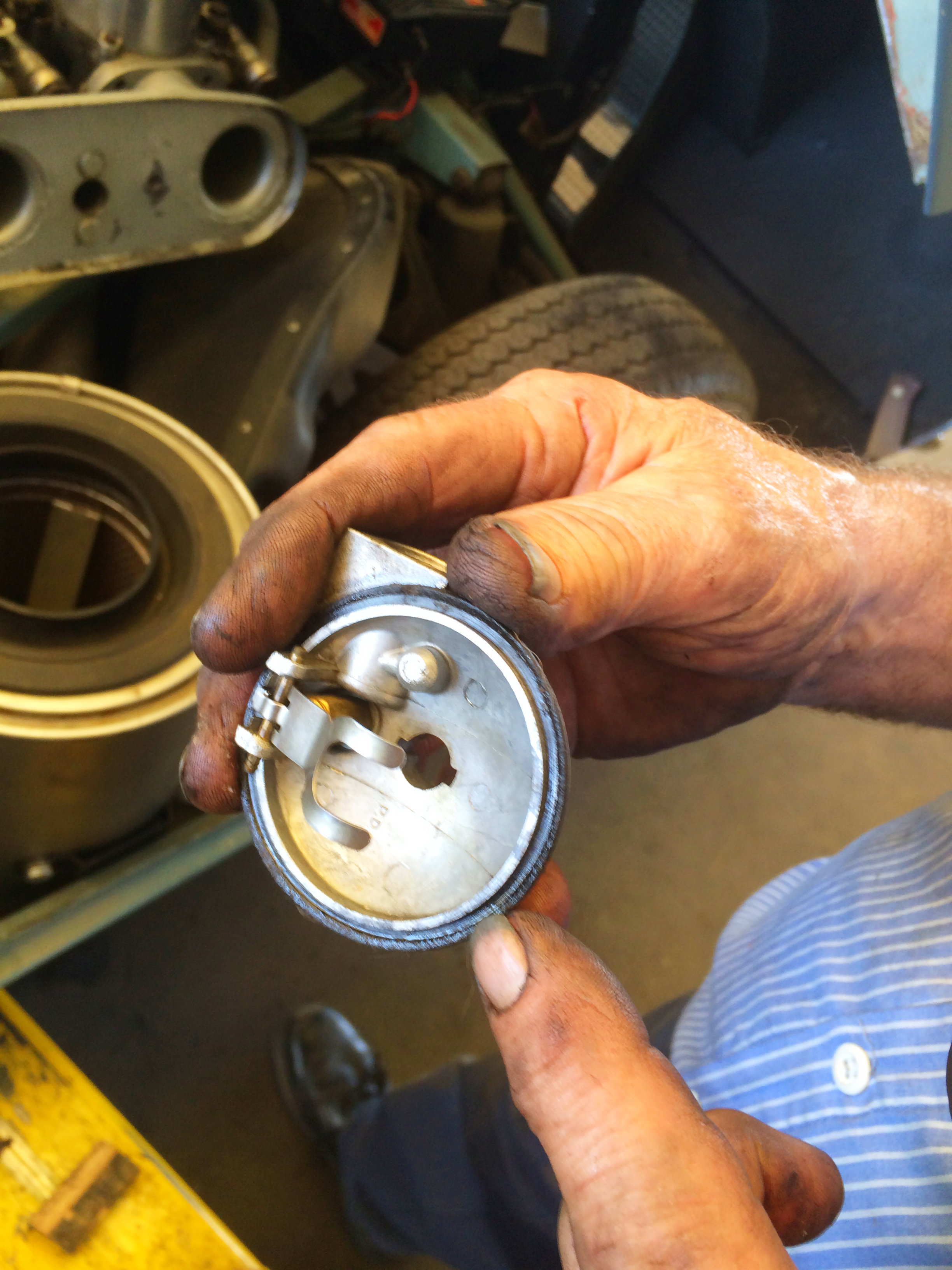

I also noticed that the three float levers are not all the same. I assume to an expert this may not make much difference but for a novice mechanic like me it is confusing.
I also read on a forum that there are two distinct float lever types one with the axial location offset by 1/8" from the center line of the lever and one a newer type which is in line with the center-line of the lever making the hole for the axial offset by 1/8 inch ! which rang all kind of bells with me.
I am wondering if this is why my float levels were miss-adjusted when I first started this refurbishment process.

On mine they were all the same. Maybe a rebuild in the past with different kits?? or parts for other jags as these were used on all of the XK engines of the day with different fule flow requirements.
