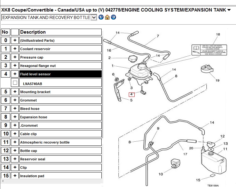

You don't need to replace the Expansion Tank. The Fluid level Sensor is available separately (item 4):
Part Number LNA5740AB. It clips into the bottom of the tank.
