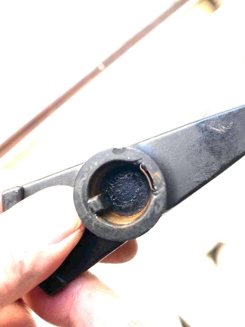

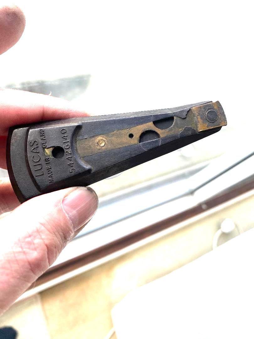

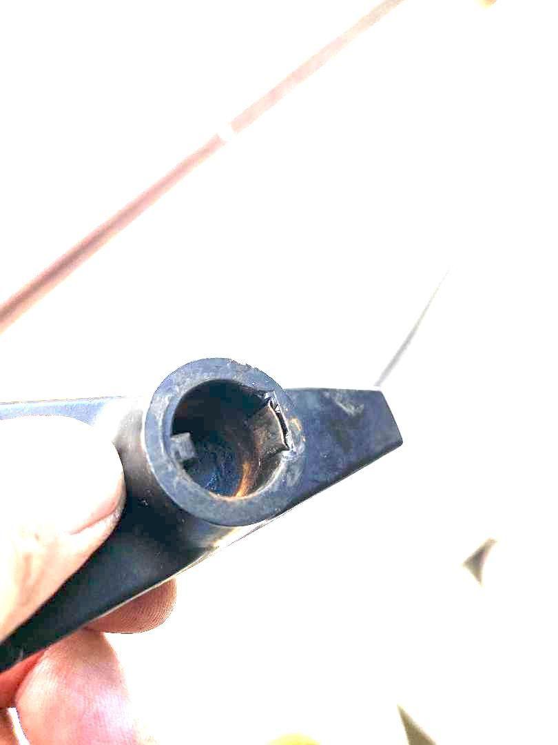

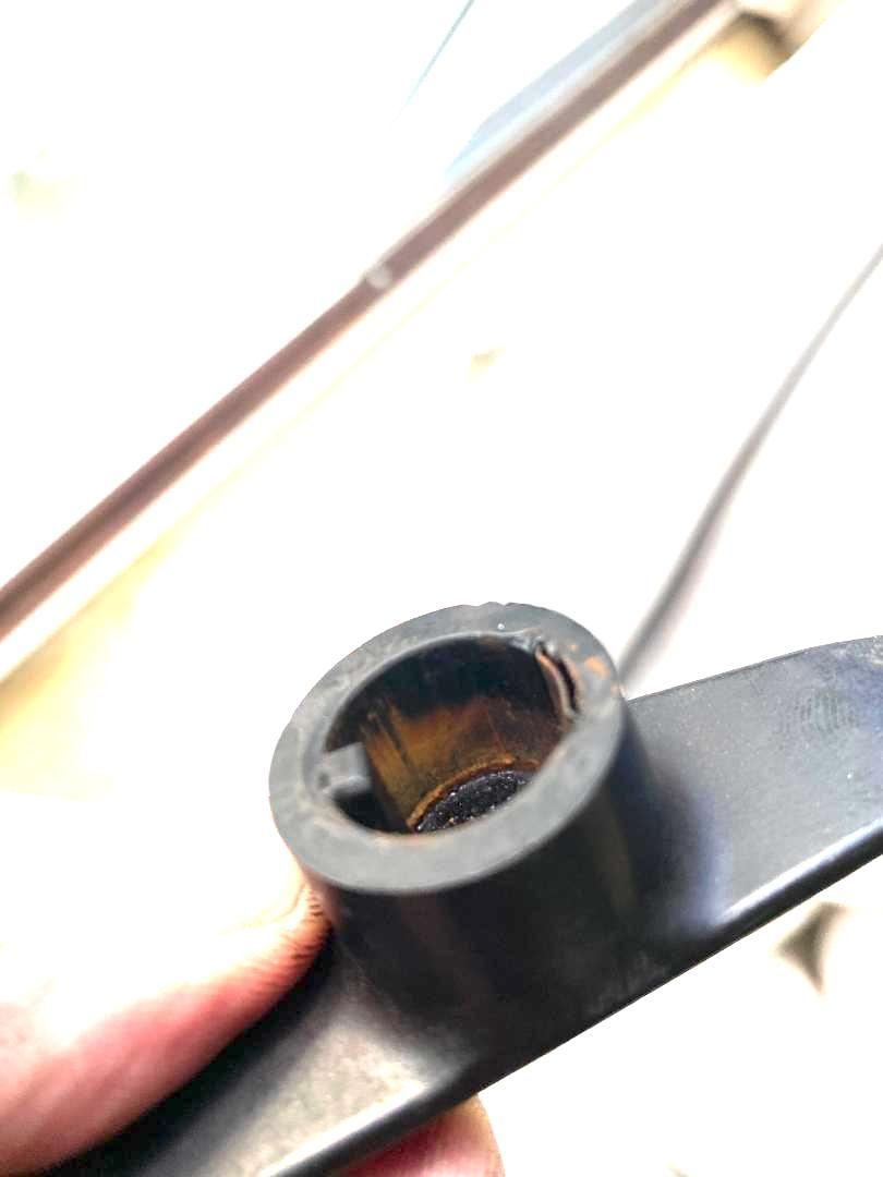

After the last breakdown I found a couple of new BL rotor arms on Ebay for a song and a new distributor cap even cheaper.( even though the existing Luca one was new ish ). A good look at the rotor arm seemed quite conclusive ie it was probably original and there were signs of trouble ( arcing that looked oddly like iron oxide ) inside. Suffice to say the problem seems to be solved and of course its idling a lot better !
